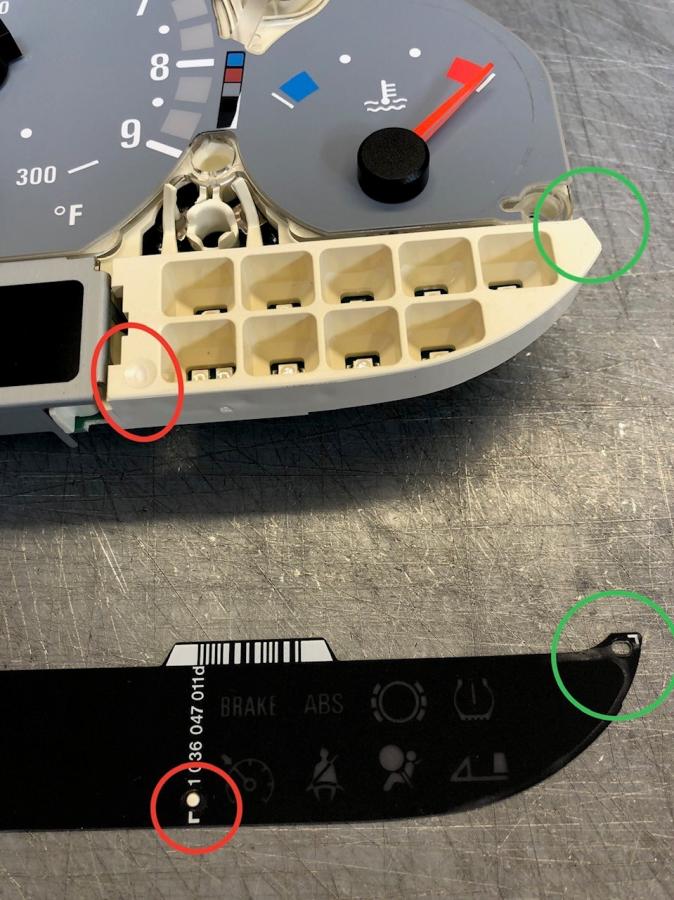

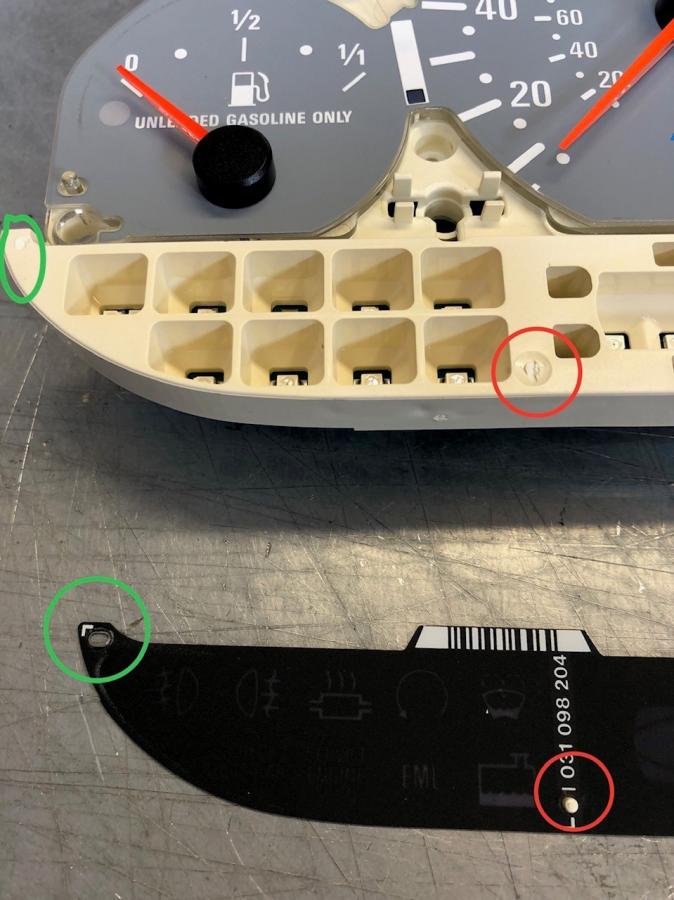

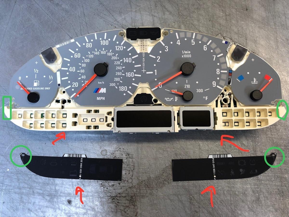

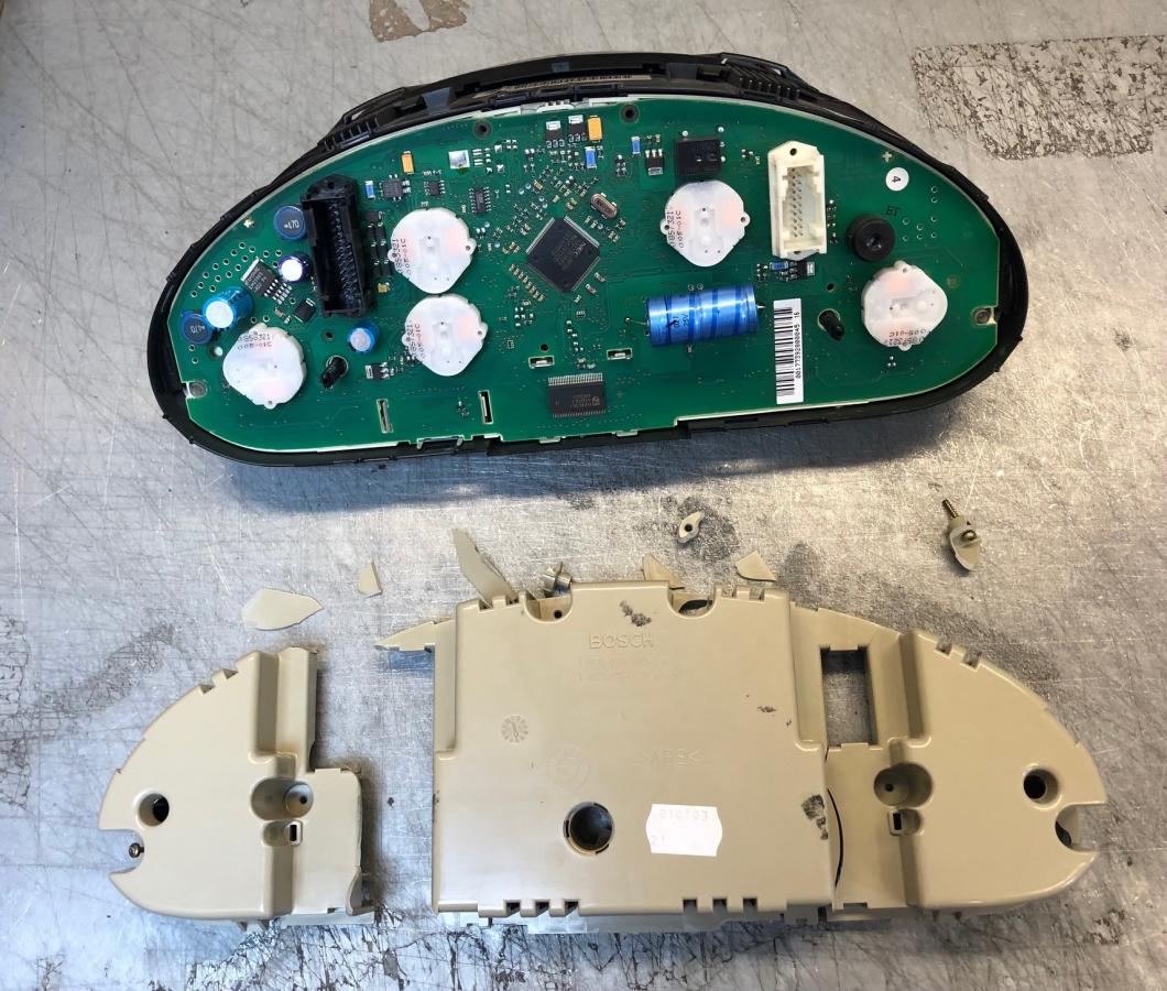

                The little pegs on the bottom that hold the LED lenses broke off, so it does seem the actual cluster itself was hit. I'm not sure if the circuit board has damage to it or not.

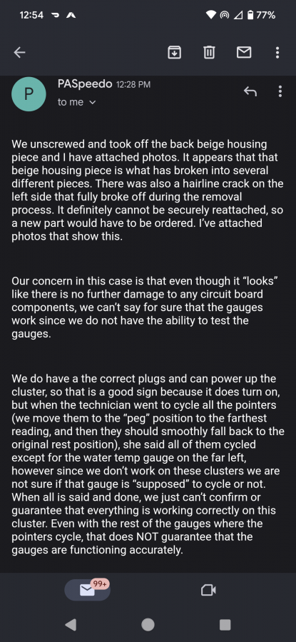

                It's at Palo Alto Speedo, and they can't tell how bad the damage is, as they don't really work on BMW clusters, they're doing me a favor.

                  I would personally plug that into the car to verify that it works and if it does, swap out all the broken plastic bits with parts from a junkyard cluster.

                      Those plastic nubs break off all the time, once the cluster is assembled the covers won't move.
                      If you wanta rear cover I have tons. Pay for shipping and its yours.
