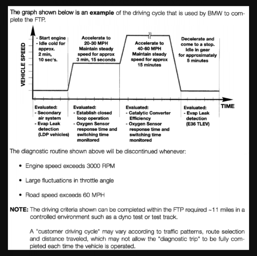

                  Here's another tidbit: If you swap back the stock DME, you have to perform the drive cycle to get the monitors ready before SMOG.
                    haha! that goes without saying, but appreciate you mentioning it. I'll add it to the list. Graphic for drive cycle in case someone is researching and wants this for reference.
