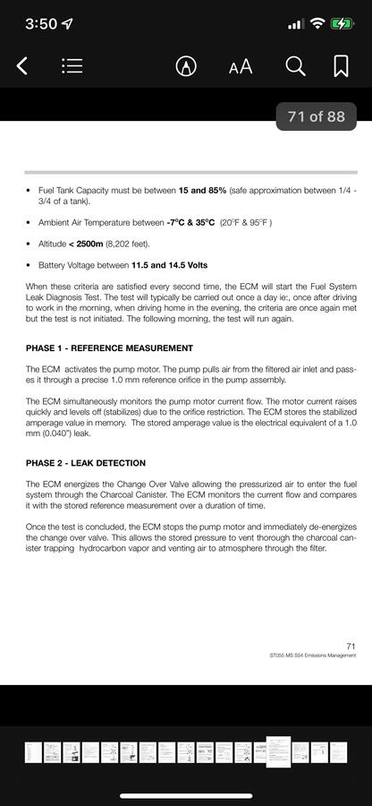

          Try DMTL pump and vanos solenoid. Both of those when faulty will contribute to similar situations. Read this document on how the car carries out the leak detection test and then try to pay attention to every single start following and see if the issue starts to occur on the second startup when the criteria listed is met. If you do a lot of short trips that criteria can take multiple restarts to be met so what appears "random" isn't really random anymore. I think you have to drive for at least 15-20 minutes for it to count as a cycle.

            Thank you for your contribution bro. I just had my vanos redone and I replaced the solenoid with one from Beisan. So I will go ahead and try the DMTL pump.

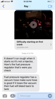

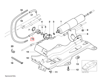

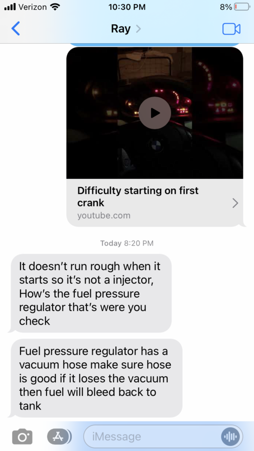

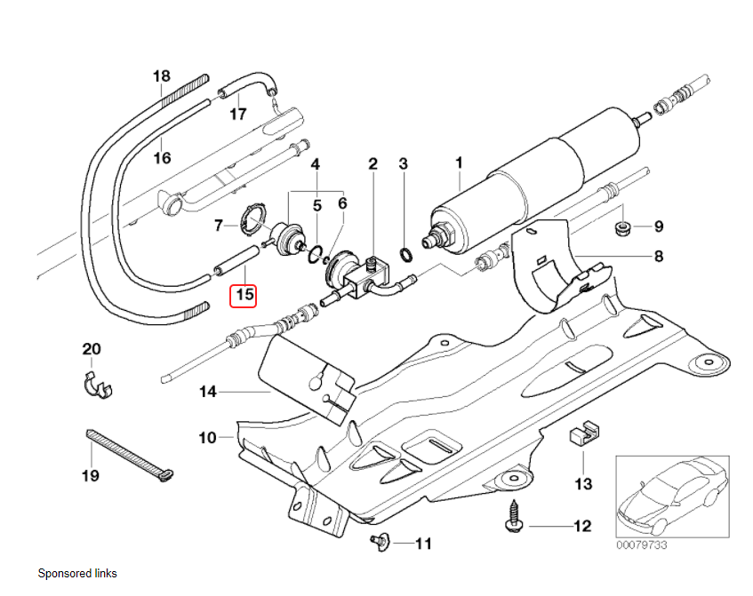

                          I reached out to a friend of a friend who’s a 25 year BMW dealership tech and showed him my video. This is what he said. I also attached a real oem diagram. I’m guessing it’s 15, 16, and 17. Cheap enough to try it out as the vacuum lines aren’t too expensive. I’m going to order the lines and replace them along with the DMTL pump which arrived today.
                          I started up my car tonight for the first time in about 2 weeks and it fired up on the first crank. This is puzzling lol.
