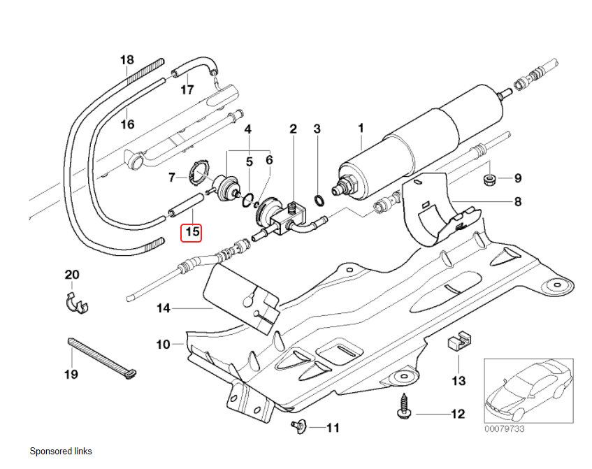

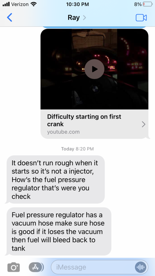

      I reached out to a friend of a friend who’s a 25 year BMW dealership tech and showed him my video. This is what he said. I also attached a real oem diagram. I’m guessing it’s 15, 16, and 17. Cheap enough to try it out as the vacuum lines aren’t too expensive. I’m going to order the lines and replace them along with the DMTL pump which arrived today.

      With 25 years of experience he should know how a fuel regulator work. The vacuum line is to balance the pressure difference that comes from the n/a engine (vacuum in intake manifold) so if the engine is off, the line is at ambient pressure (like when it’s plugged off). So if you drive without the attached line, you will end up with a massive rich mixture.
      And in my opinion only that the engine runs not rough, doesn’t rule out a faulty injector. Some injectors that are clogged, can leak when they get very cold and flood the combustion chamber. But when they get to operating temperature they work as usual. A professional injector cleaning and checking should be always on top of the list.
      But if part number 4, the regulator it self is faulty it can indeed leak fuel back in the tank.

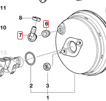

                  Hi There - I had a similar issue when coldstarting the car, in my case it was the brake booster 1 way valve, i replaced it starts right away without any issues no matter how quickly i turn the key to start it. I replaced 7, 6 and 8 (used worm clamps)

                    Thanks for your response. I never would've thought a brake booster check valve would cure a cold start issue. Would you mind explaining?
                      I dont understand the mechanics behind this either, but i replaced all components in this thread + more and still had this issue. After that i noticed my brake pedal was increasing harder to press in cold mornings to the point that every time the car cooled off it would be hard. After replacing the 1 way valve it seems to have resolved the issue. Its important to understand that this is a one way valve with a diaphragm, i assume (i have no technical data here) that its not meant to work bidirectionally and hence it was leaking air a way it shouldn't. In my situation i could repeat the hesitation on coldstart by turning the key really fast (trying to start the car as fast as possible) and when in coldstart i would start it slow then turn the car off and on and it would struggle.
                      I guess an easy way to tell is if you have the hard brake pedal on cold mornings.
                      I hope this info helps

                        Re: the other suggestion, I actually did try replacing the booster check valve lol. Didn't help my case, but hopefully it helps otheres!

                          Leaking check valve will pull more air than is metered and cause a rough start condition.
                          You can check fuel trims if vac leak is suspected.
