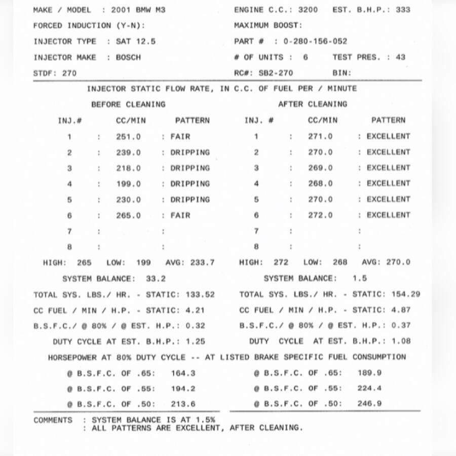

                I mentioned this last week but I’ll update here. I purchased a set of “clean” injectors from another member. I installed them in my car and the problem was still happening. I sent my old injectors out for a cleaning to RC injectors in CA. I’m going to pop these back into my car.
                These are 72k injectors.
                  I wonder the injectors that dripping during ON or OFF. If dripping during off (injector closed) then they created a rich mixture or flood condition for the next start up.
                  My guess they were dripping due to the bad spray pattern and not dripping when closed.

                      I’ve cold started the car every day for the past week. It only happened one time and that was the morning right after I replaced the DMTL pump and the filter next to it. Still not sure about the injectors I put in my car but I will be reinstalling my original injectors now that they are cleaned. I will also be replacing all the orings on the air rail.
                      I don’t want to jinx it but I think I’m getting closer to solving this. 🙏💪

                              I can’t wait to get MY injectors back in there along with all new air rail orings.
                              Im hoping the combination of the temporary “clean” injectors and the dtml pump did the trick! 🤞
