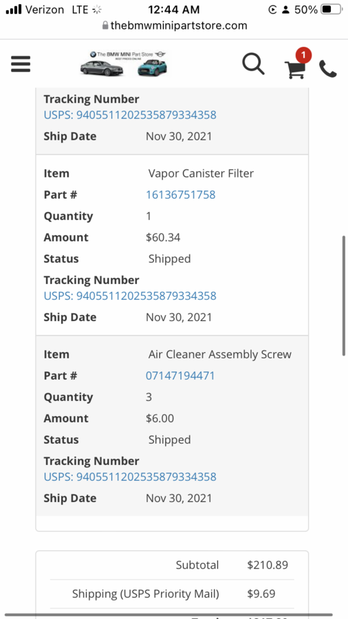

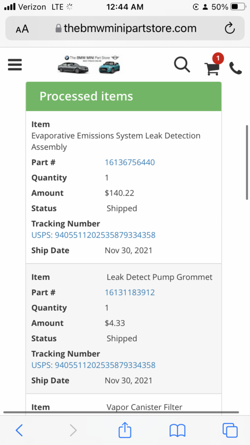

          i replaced the air pump, the filter, and the grommet that goes onto the air pump. I also threw in a set of temporary injectors at the same time while I sent my original ones out for a cleaning. All is well so far 7/8 days it started on the first crank 🤞

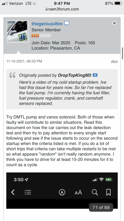

              sapote read this post in this thread. It’s #65.
                      I had read it and understood how the diagnosis works, but don’t see how it affects the starting.
