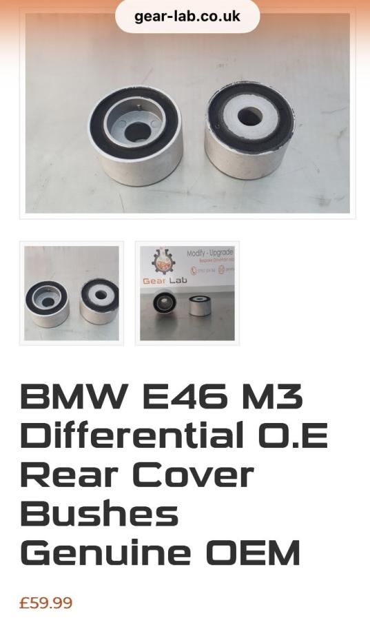

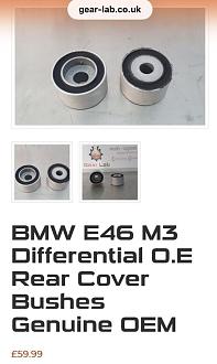

                      Anyone know anything about these?
                      Genuine BMW E46 M3 Differential Rear Case Bushes Only sold as a pair. Excellent Quality item revised from the original foam bushes now in solid Rubber-Metal Mount Direct replacement for your old worn out bushes.

                        look like the e36 bushing, fwiw my 01 had those in the cover when i removed it, but unsure if they were original or not, the r&p was replaced with a 4.1 around 60k miles
                          Visually it's clearly a different part, though perhaps for 01 cars it was different (the part was superseded in Mid 2000 and then again in 2002)

                            Yes, the early E46 M3s had the E36 style rubber bushings
                              I thought they were E36 also. But the Corteco (who is said to be the OEM) have different markings on them (in the rubber). So wasn’t sure.
                              Interesting didn’t know early E46 M3 used the E36 M3 diff cover bushes.
                                Click image for larger version  Name:	image.png Views:	68 Size:	366.6 KB ID:	356277​
                                That was the first thing I noticed too when saw the listing the E46 M3 bushings having the part number on the inside metal ring (and colored foam) . Reason why asking if anyone knows more about this part.
                                They also list their E46 OEM M3 bushing as “..item revised from the original foam bushes now in solid Rubber-Metal Mount”.
                                So can’t tell if this is a bushing made by Corteco differently or if even Corteco (maybe Febi-Bilstein) but material changed up. Or if this is actually just the E36 M3 one being marketed as OEM E46 replacement?
