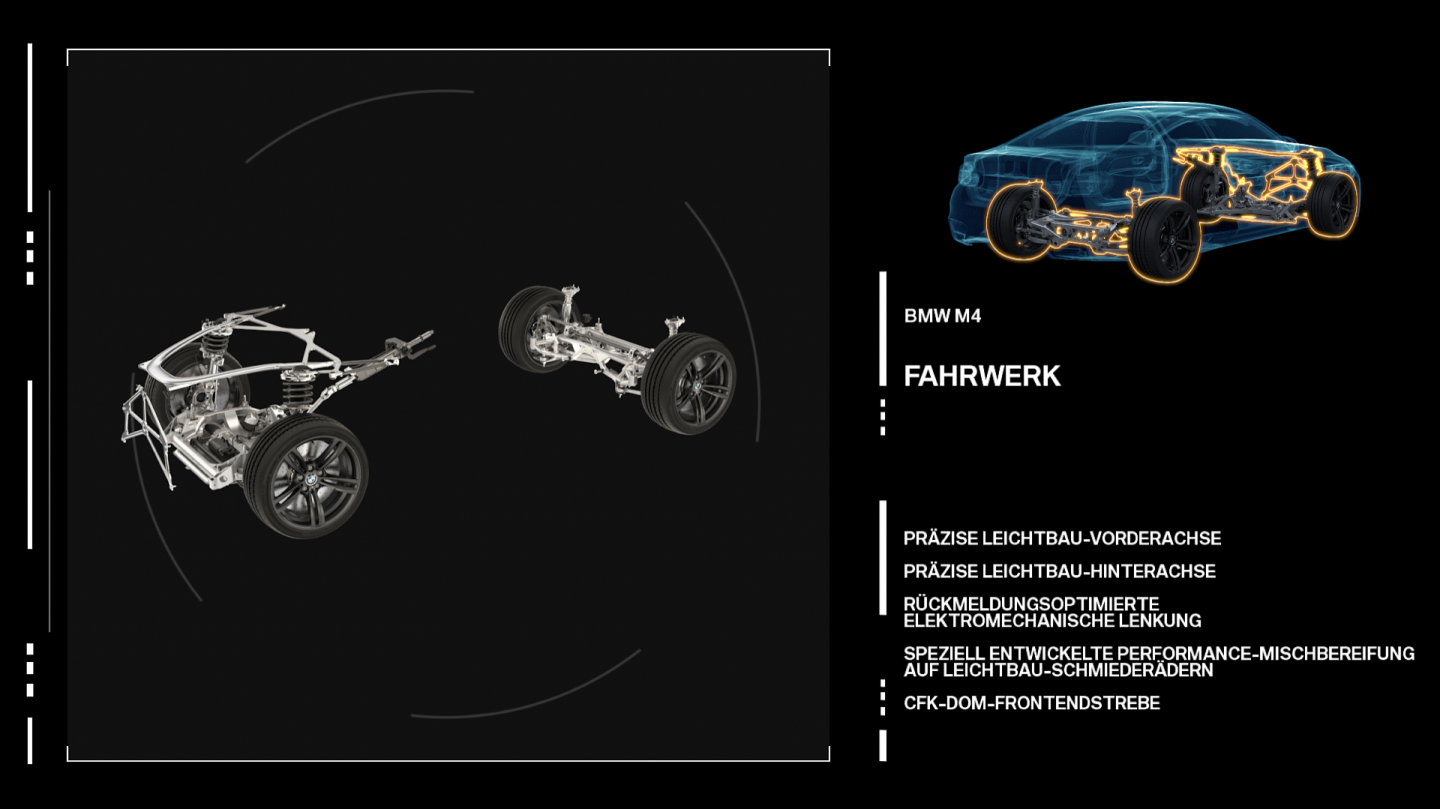

                      Absolutely beautiful piece. And for those skeptical of rigidity benefits -- there's probably good reason BMW is doing similar stuff in most of their cars since the E46. Like everyone else, I wish it wasn't $5k + install, but you have to pay for quality.
                      Click image for larger version  Name:	image.png Views:	0 Size:	1,004.9 KB ID:	230590
                      F80 and G80 are interesting in that the firewall and front clip are braced
                      Click image for larger version  Name:	Installing KW H.A.S. Suspension  BMW G80 M3 00-15-24.png Views:	0 Size:	1.09 MB ID:	230591​
