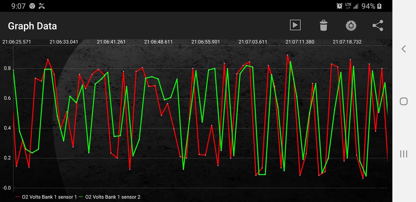

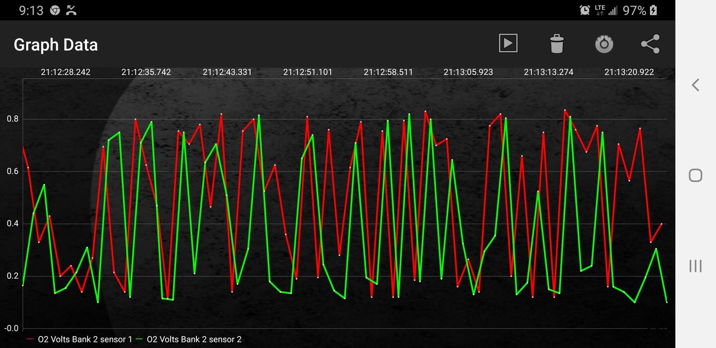

    So I've been smelling excess fumes (2005 M3) and tried digging into it. I'm having trouble passing emission (Evap and O2 sensor heater are not readying up) and I downloaded the torque app. I'm getting the below real time data from the 4 O2 sensors. INPA is throwing up P0178 and 0179 codes from cat low efficiency. Can anyone tell me if my cats are bad? I have the SSv1 stepped headers and the matching sec 1 with HJS 200 cell cats). If so what are the best 200 cell cats to weld in (without going broke)?

    That your post-cat sensors are following your pre-cat sensors is definitely a bad sign, but wait for someone who knows what they're talking about. How many miles on your cats? Those are expensive cats to have to have gone bad, I'd be losing my mind if I paid for a catted SS sec 1 and the cats went out. I hope there's another explanation!
      Me too... I'm like wtf?? Cats have about 20k miles on them.
