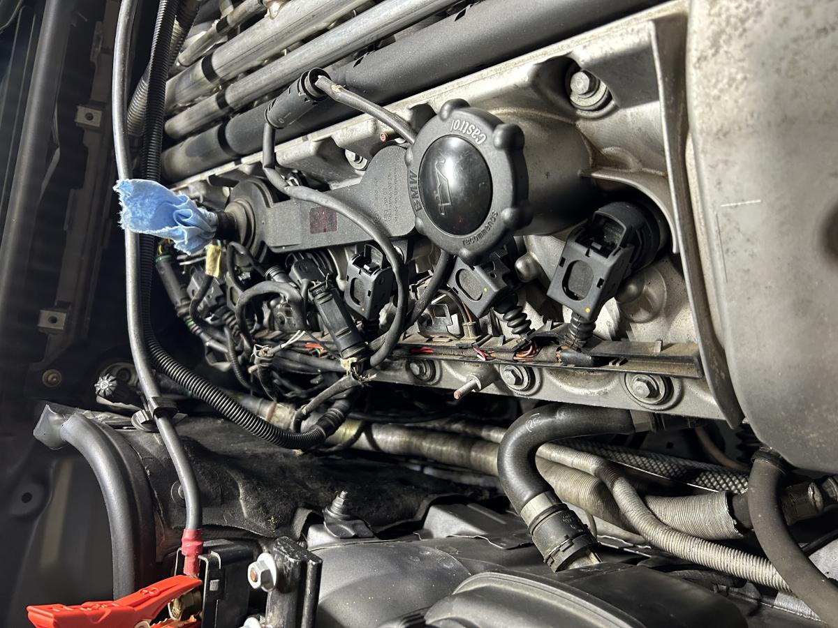

    In process of changing exhaust system and removed the beauty cover to find that the oxygen sensor bracket is missing and the o2 sensor connections were just lying in top of the valve cover…wires frayed…what a mess.
    Cannot find this part number on realoem to save my life. 1st blurry pic for reference.

      This was what I found underneath the cosmetic cover

        the plastic bracket piece is what i’m having trouble finding. hard to explain but the picture above is exactly how I found it, and I cannot locate the cover there above the exposed wires...I think this may just be part of the wiring harness and i'm probably out of luck in that case lol

          I'm not an expert on this but I think there's a metal bracket that's held in by to bolts. The 2 rear O2 sensors and EGT sensor plugs clips into there.
            really appreciate the suggestions. i have the little metal bracket, but I think what I need is part of the ignition harness 12517831537

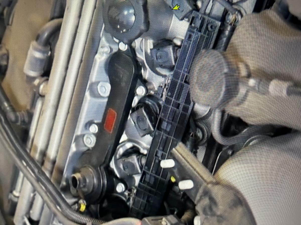

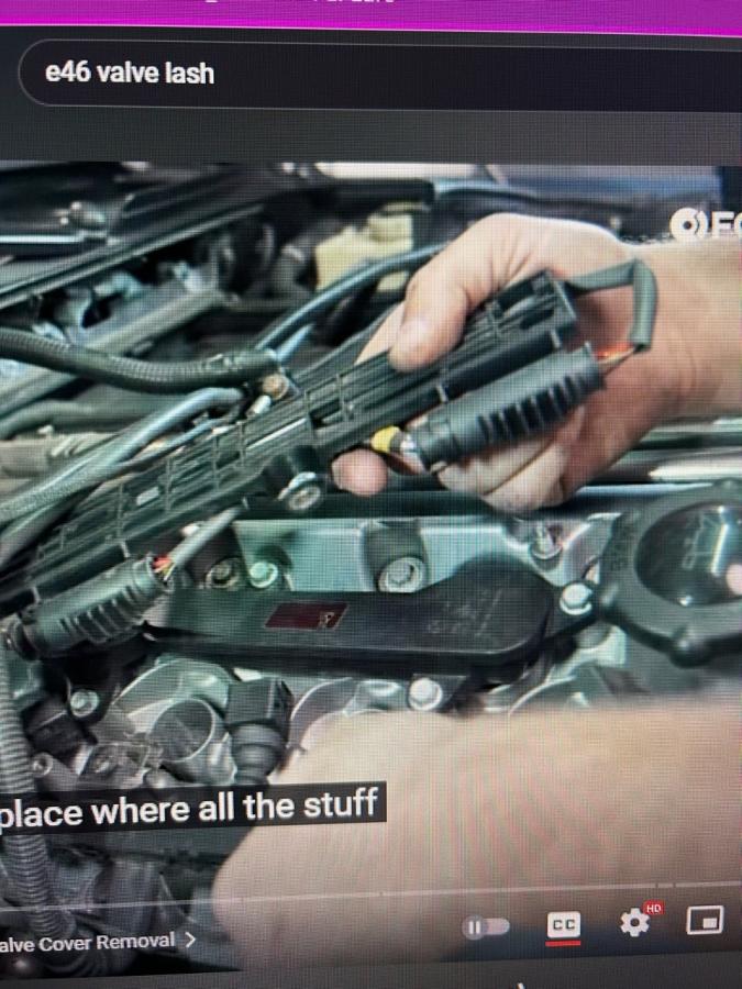

              it’s this plastic piece that hooks the front o2 sensor in the fcp video.

                      That O2/EGT cable holder is part of the transmission module harness, doesn't look like BMW sells it separately.

                          thanks for the input everyone! it does look like it is a part of the transmission wiring harness 12517835540.
