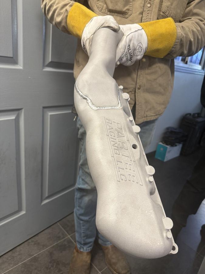

                    Thank you for all your information in this thread - it's very interesting! I'm curious to hear if Partee is working on anything in the 3D printing space? I've seen some builds out there (not BMW) where people will use SLM printing to make manifolds - given Partee's knowledge around fluid dynamics, I was wondering if this is in the works - for the E46 and/or the E39.
                      #55
                      The proliferation of affordable DLSM metal printing represents a paradigm shift in manufacturing for companies that specialize in niche markets. In mid-2024, we had our S62 Power Steering reservoir/thermostatic oil filter body quoted for 3D metal printing because it had become quite cumbersome to produce with billet- the quoted price was over $15,000. We just wrote off 3D metal-printed parts as "not this decade."
                      Then I started working with 3staxontheradio on a few different projects, and he enlightened me to just how affordable it had become. Absolutely blew my mind! I legitimately could not sleep for days after I got a few test quotes in and even ordered 10 parts (that are a pain to machine, for not much reward) as a test to see if it was legit. As I type this, I have a few thousand dollars' worth of 3D-printed parts on the way, in AlSi10Mg and 316SS. Oh, and some Sterling Silver jewelry I designed as a gift, lol.
                      There are so SO SO many projects that I have wanted to do for years that were just prohibitively expensive to machine or have cast, and now- DSLM printing isn't just affordable, it is economically viable as a production means. We have a lot of things all cooking at once. In all honesty, my excitement on the topic has left me a little stretched thin and scattered because I immediately pitched Peter 10 different projects, all of which he was also just as excited about.
                      So now I have to deliver lol.
