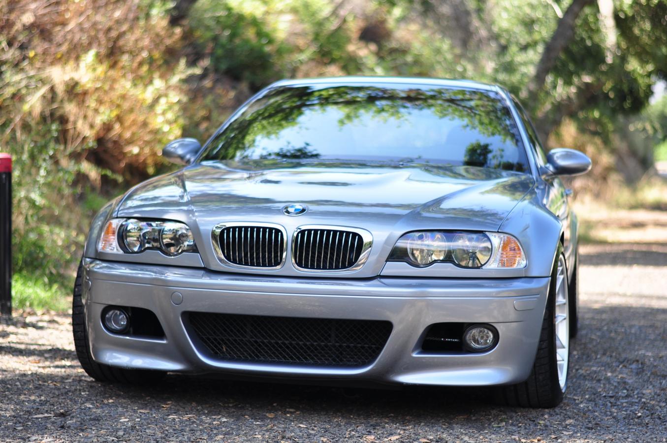

    I put pre facelift zkws in my facelift car cause I liked the clear look vs fluted. Not sure on price differential.
      I cracked one of my originals on track so replaced them both with ZKW. Surprisingly big clarity difference even at only 45k miles. ZKW was the same as the OE BMW that came out as far as I could tell. About $100 each from FCP a couple years ago.

        I didn’t know fluted was only on LCI models. I prefer the clear lenses too so definitely going that route.
          Tyler, I believe all E46 M3s came with fluted. My 2001 originally had fluted but I switched to ZKW clear around 2009.
            No, 01-03s came with clear lensed fog lights and updated 03.5-06 came with fluted.
            Yours were changed by one of the previous owners.
              Very interesting. Thanks for this!
