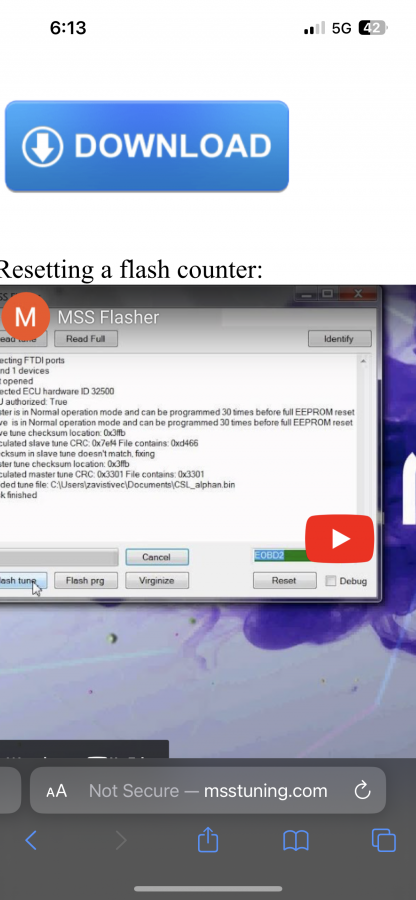

                I think that’s an option in mssflasher..
