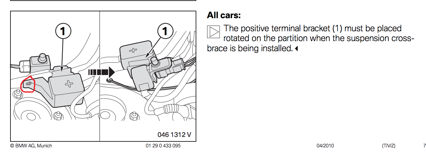

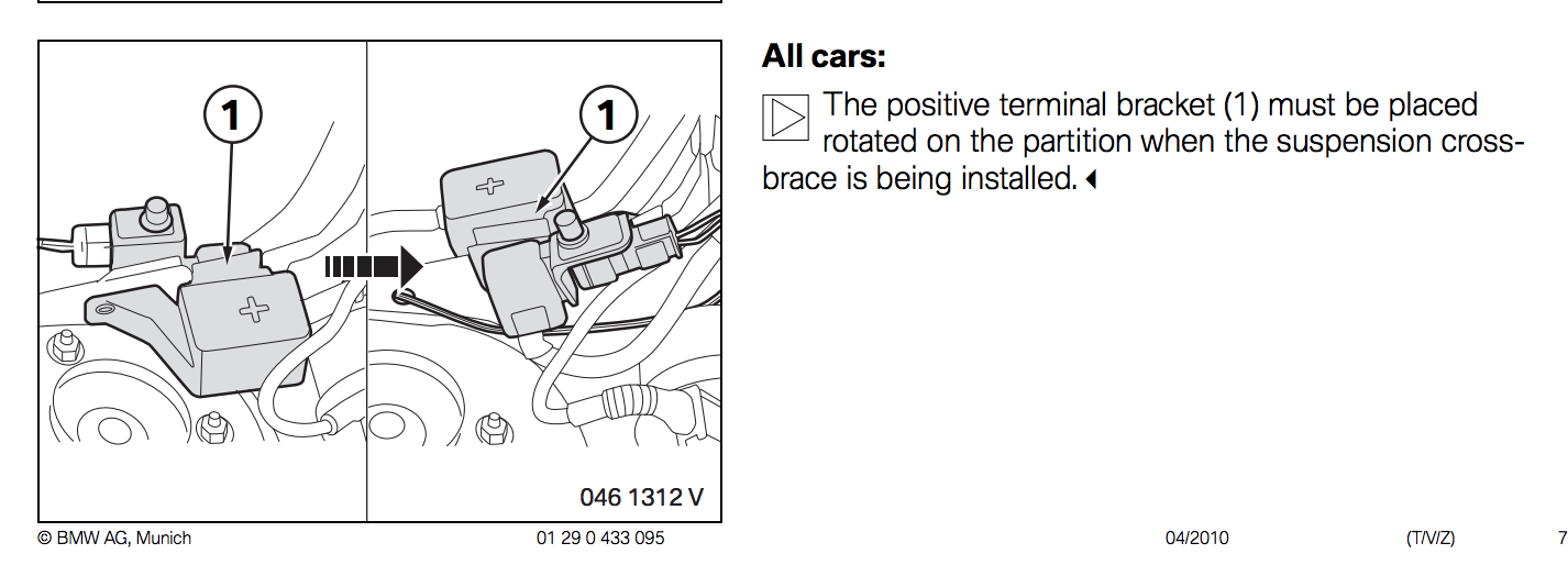

    Found a guide from BMW on how to invert the Positive battery terminal in the engine bay so it does not interfere with the strut tower brace. Has anyone done this? Found a write up on E46 Fanatics but all the pictures are MIA.
    I'd love to see some pictures of what the finished product looks like vs sketch drawings. I am having a hard time figuring out how this works and would appreciate any pointers. Full BMW PDF for the M Performance Strut Tower Brace install attached for reference.

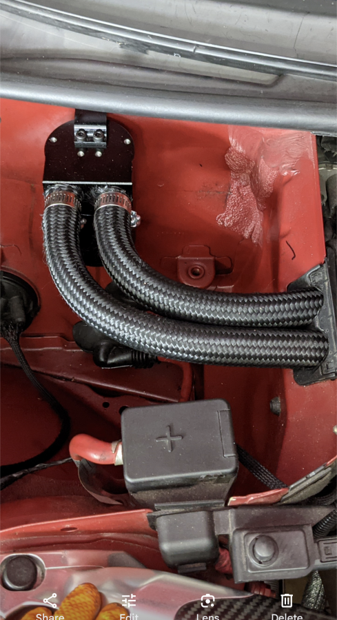

    📸 @alpinem3
    M3F forum member with a E46 S54 Sedan did this modification:
      Thank you! That’s exactly what I needed 🤝

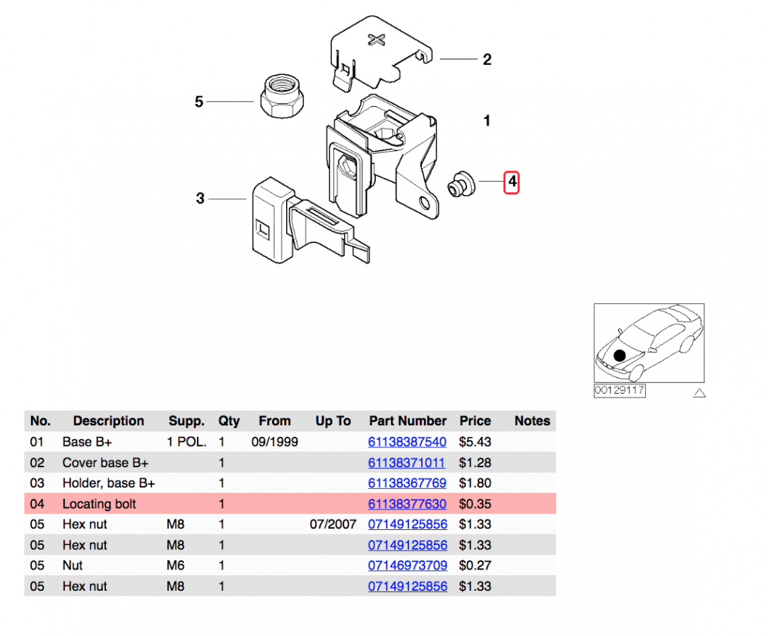

          Anyone know how this fastener is removed? It's not jumping out at me...

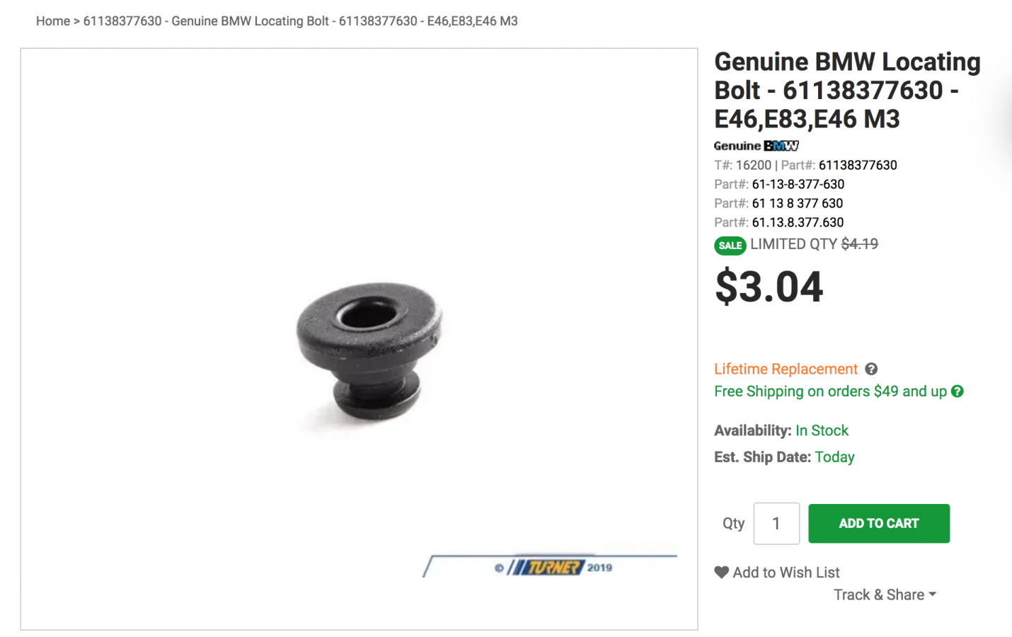

            Appears to be a rubber grommet of sorts. Pry off would be my guess based on the diagram and reviewing the part. Diagram from realoem:

              📸 @alpinem3
                Slide # 3 up and it will release the plastic locating bolt.

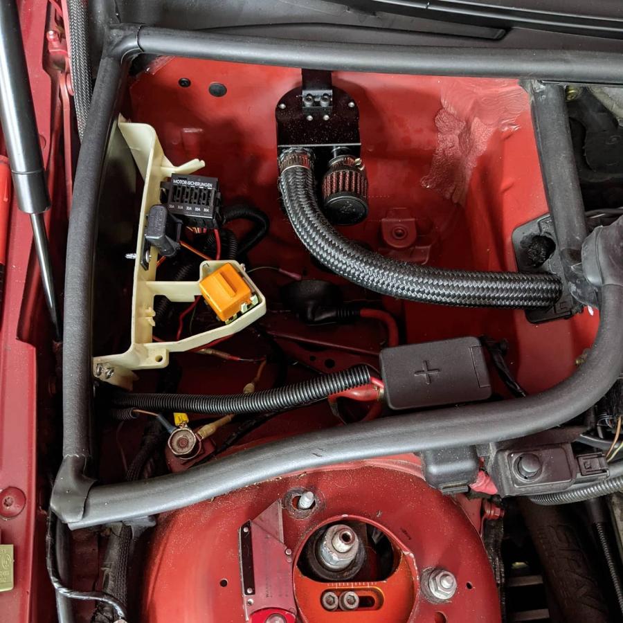

                      Had to do this as well with my cf performance brace. It's definitely little wonky when all said and done but it's necessary
