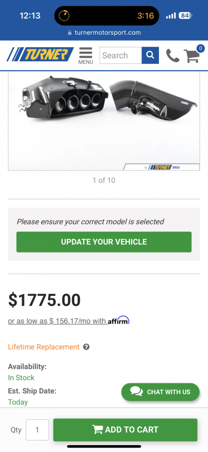

                    Karb Race is in stock and ready to ship today via Turner. Cheaper than buying from Karb and zero wait time. Also backed by Turners new lifetime warranty. I bought one last week. Way better than waiting 3+ months and then having to spend another 1k+ on a snorkel and ducting.
