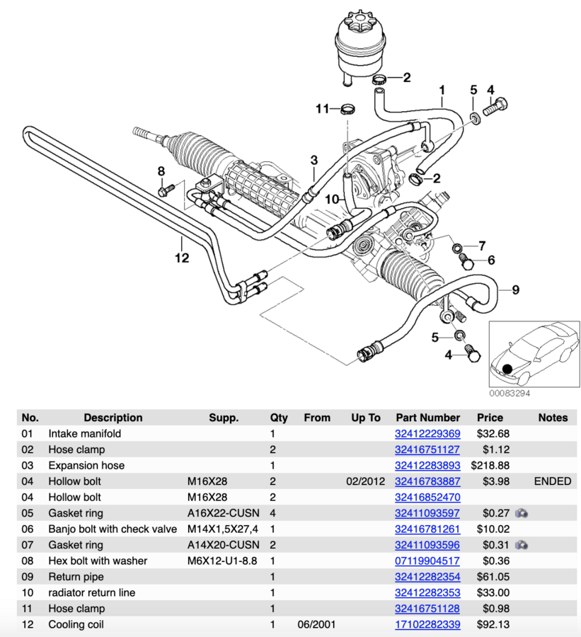

    Looking to pickup one of these and know some users on the old forum had the kit but with those resources gone, I'm looking for new info. Chase Bays doesn't seem to provide a ton of info on how their kit integrates into the E46 M3 in terms of mounting locations and what gets replaced, etc.
    It appears their kit replaces items 3, 9, and 12 from the realoem diagram below and cuts it down to 3 simple connections. What's a little confusing is what justifies the need for the power steering cooler option based on your usage. With the removal of the OEM cooling coil (#12 below) I would imagine this would justify the need for Chase's power steering cooler, but wanted everyone's take. My car is dual purpose street/track, about 50/50 usage for each. I have never had serious issues with the stock setup other than notorious weeps, so just trying to figure whether the cooler is overkill or actually essential with the removal of the oem cooling coil?
