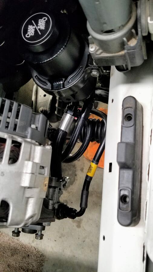

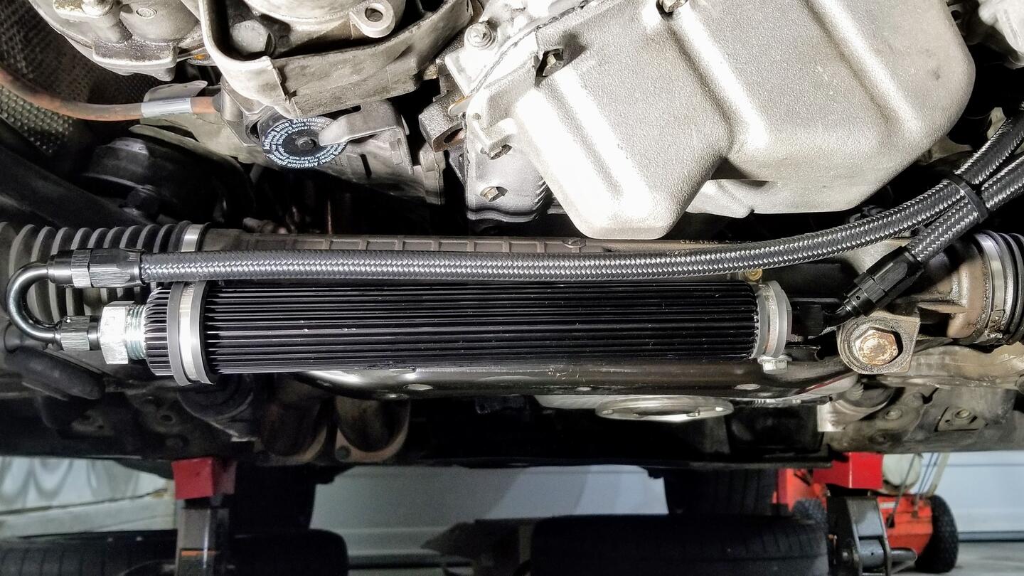

                        Here are photos from the way I chose to install. A few notes:
                        - This install includes the cooler option from CB (+$100). If you don't use a cooler, you will get a short line to go from 'rack out' to 'reservoir'
                        - Hose routing is up to you but lengths are sufficient for a few options
                        - Everything you see is included with the CB kit except for tools to drill/tap the rack boss, a small clamp and the fluid level indicator on the reservoir.
                        - The cooler isn't specifically designed to fit amongst factory parts but with the way I mounted, everything fits well, including the plastic underside tray. I think you could skip drilling/tapping step, and ziptie the cooler to the rack directly. Not as clean but effective.
                        - I capped off the empty factory PS cooler loop in the radiator assembly with some plastic plugs. You could tape off, or just leave open but keeping dust/debris out seemed prudent for whatever the future may bring.
                        - There is banjo fitting with a check ball inside on the 'rack in' connection with the factory lines. With the CB kit, no check mechanism is necessary due to the design of the reservoir, per Johnny at CB. I was skeptical but I've got 500 miles on this setup and its works flawlessly and no pump noise.
                        Happy to answer any other questions.
                        Update related to red text above: I started to develop pump whine during low speed maneuvering. I was then determined to re-install the banjo bolt with check ball, which is easy to do by purchasing a 14mm banjo to -6AN adapter ($12). I shared progress with Johnny who said yes indeed, they have discovered that with the E46 M3 the check mechanism is often needed. They either offer now or plan to offer the same adapter I purchased.
                        No more whining noise, happy to say.

                            Couple photos of my install, the only "complaint" I have is the line from the reservoir to the pump is a bit tight and tightening the connections was a bit of a PITA. Can confirm the cooler fits under all the OEM belly pan components.
