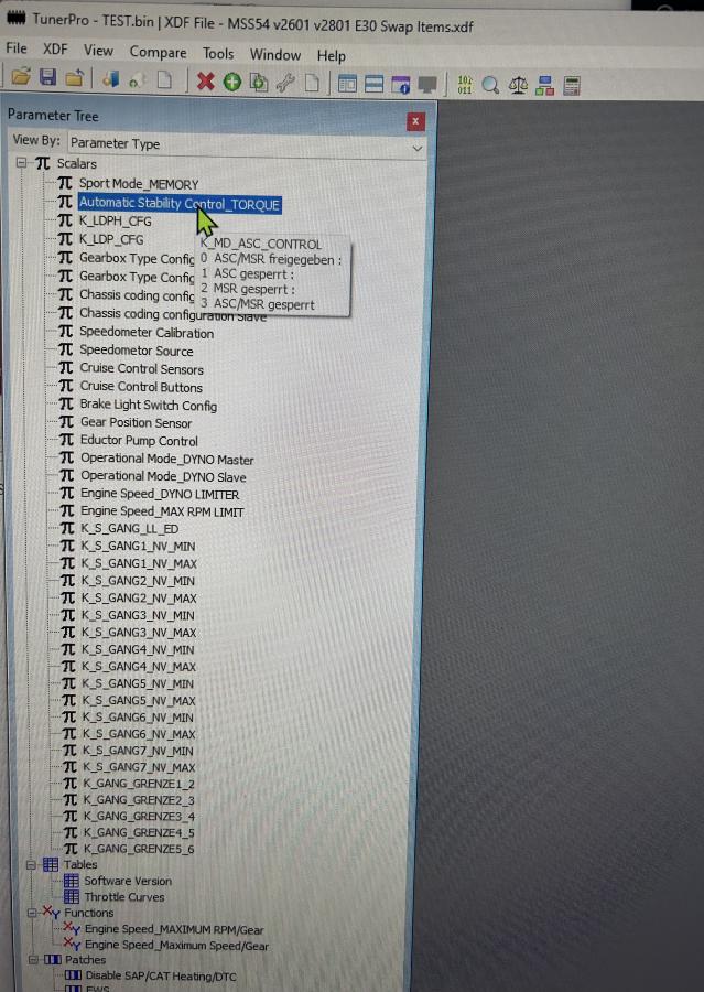

      I may be wrong, but I think changing this via tunerpro to block ASC/MSR. Not 100% if it will block at startup, hope someone else can confirm
