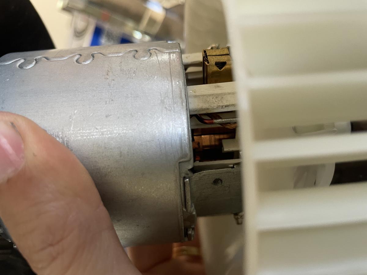

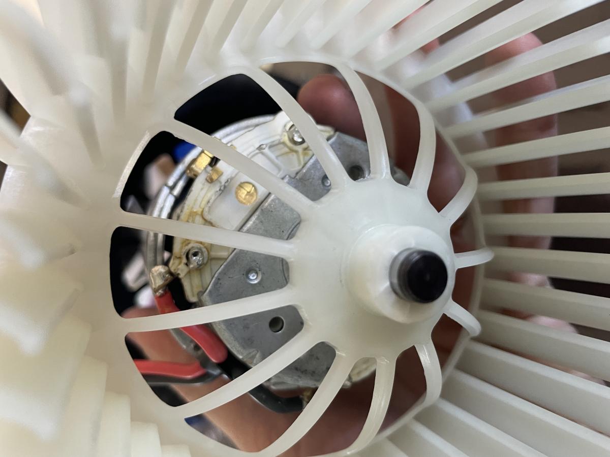

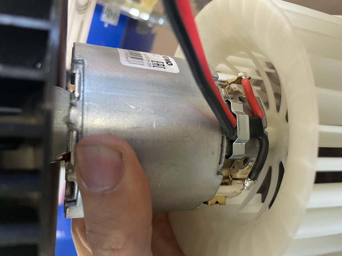

    I bought a Vemo replacement blower motor and I'm comparing it with my Behr original. It looks like I would be better off returning it and going with Genuine ($100 for the Vemo unit vs $260 for the Genuine). What do people think? Here are a couple of images showing what I mean. (Note: I am hesitant because removing the blower motor was much more difficult than I expected. ~ as the saying goes, do it right or do it twice)

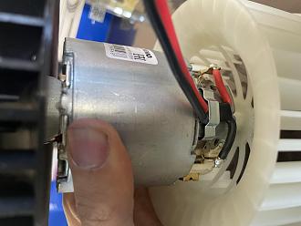

    Vemo:
    Click image for larger version  Name:	IMG_4752.jpg Views:	0 Size:	76.5 KB ID:	237118

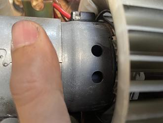

    Original - shows more protection to the motor:
    Click image for larger version  Name:	IMG_4753.jpg Views:	0 Size:	76.6 KB ID:	237119
    Vemo - looks like it's missing a top cap:
    Click image for larger version  Name:	IMG_4751.jpg Views:	0 Size:	88.5 KB ID:	237122
    Original - with metal top cap protecting the internals:
    Click image for larger version  Name:	IMG_4750.jpg Views:	0 Size:	110.8 KB ID:	237120
    Vemo (wire clamped and welds exposed)
    Click image for larger version  Name:	IMG_4755.jpg Views:	0 Size:	79.5 KB ID:	237121

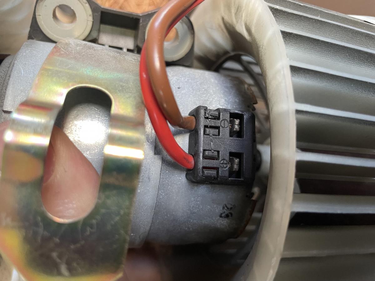

    Original - automotive grade connector:
    Click image for larger version  Name:	IMG_4754.jpg Views:	0 Size:	111.2 KB ID:	237124
    So what do you guys think? Is the Vemo design cost-optimized to be cheap or was it improved to make it transfer heat better?
    The original motor's bearing is seizing, the motor is squealing and smelling like burnt plastic. I am suspecting the design was altered to optimize heat exchange and by removing a connector that tended to be more of a fire hazard than something beneficial.

    Vemo:
    1. Original - shows more protection to the motor:

    None of the protective caps are important:
    1. Who cares if the brushes and commutator are not covered? Make sure there is cabin filter and don't drive on sand dune without one.
    2. It's just the wires cover. I mean it is a simple brushed DC motor and nothing fancy inside to protect.
    3. Soldered wires is better than connector, regardless automotive or spacecraft grade.
    I would try with Vemo unit.

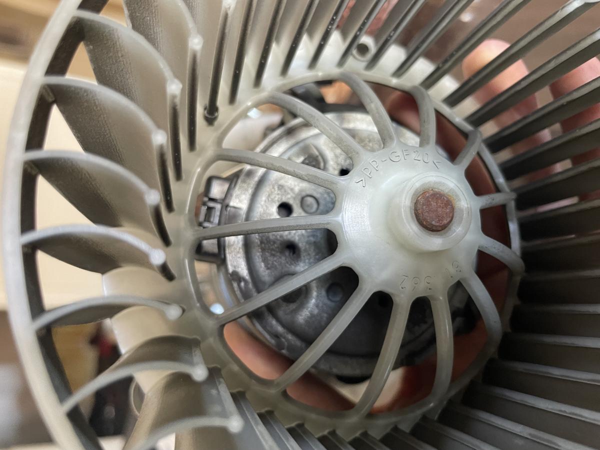

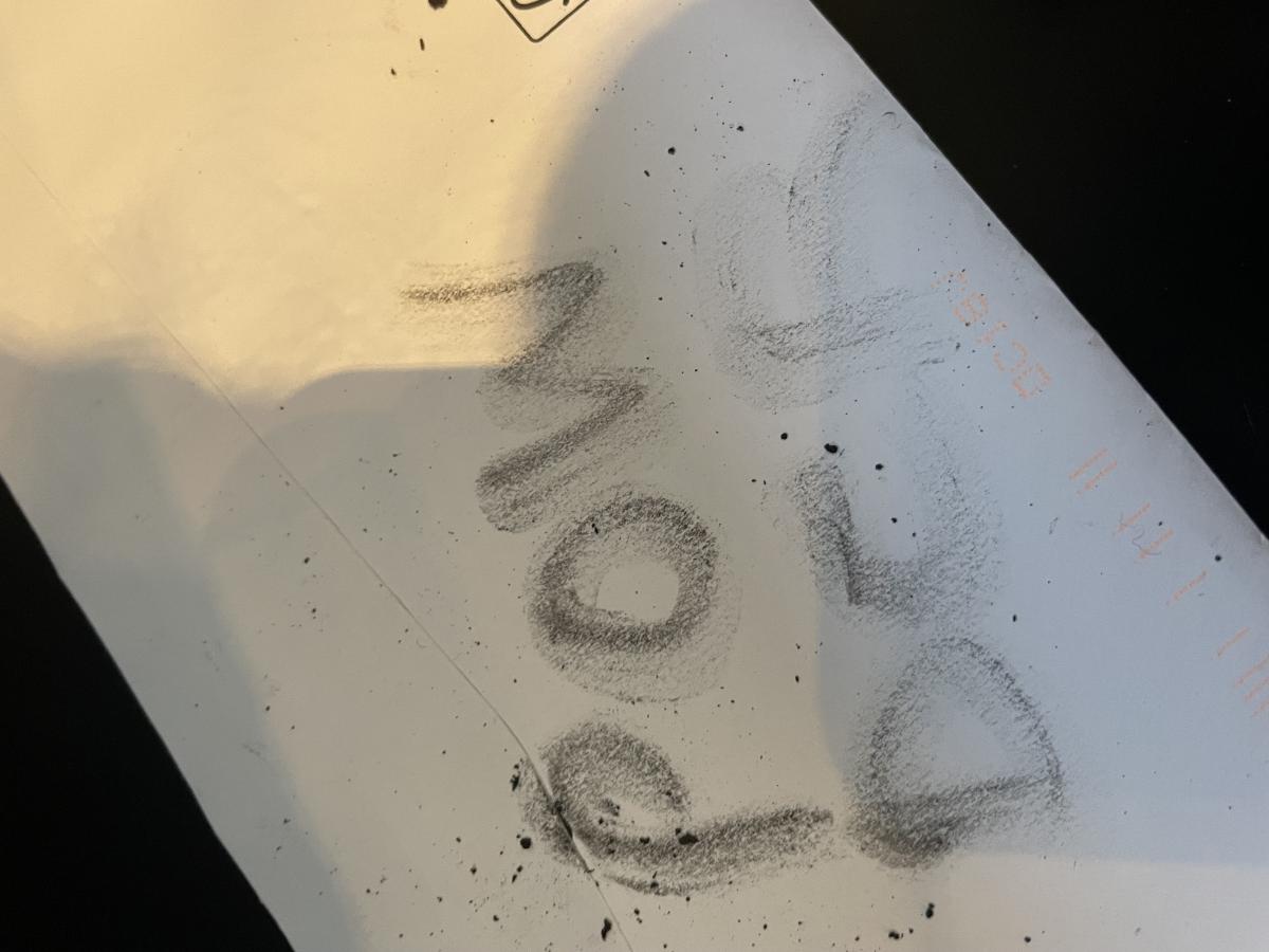

                    ​Cricket chirps / squeaking sound. I guess it was the bearing? It is full of very fine grain black dust falling out of it. Looks like a powder. I wonder what it is, dirt? Charcoal from filters installed backwards?

                      Probably dried bearings.

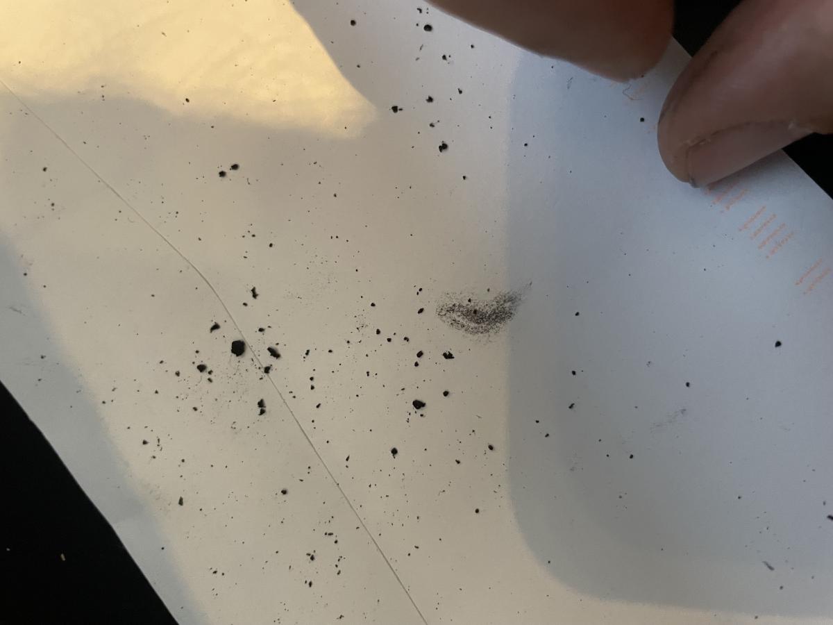

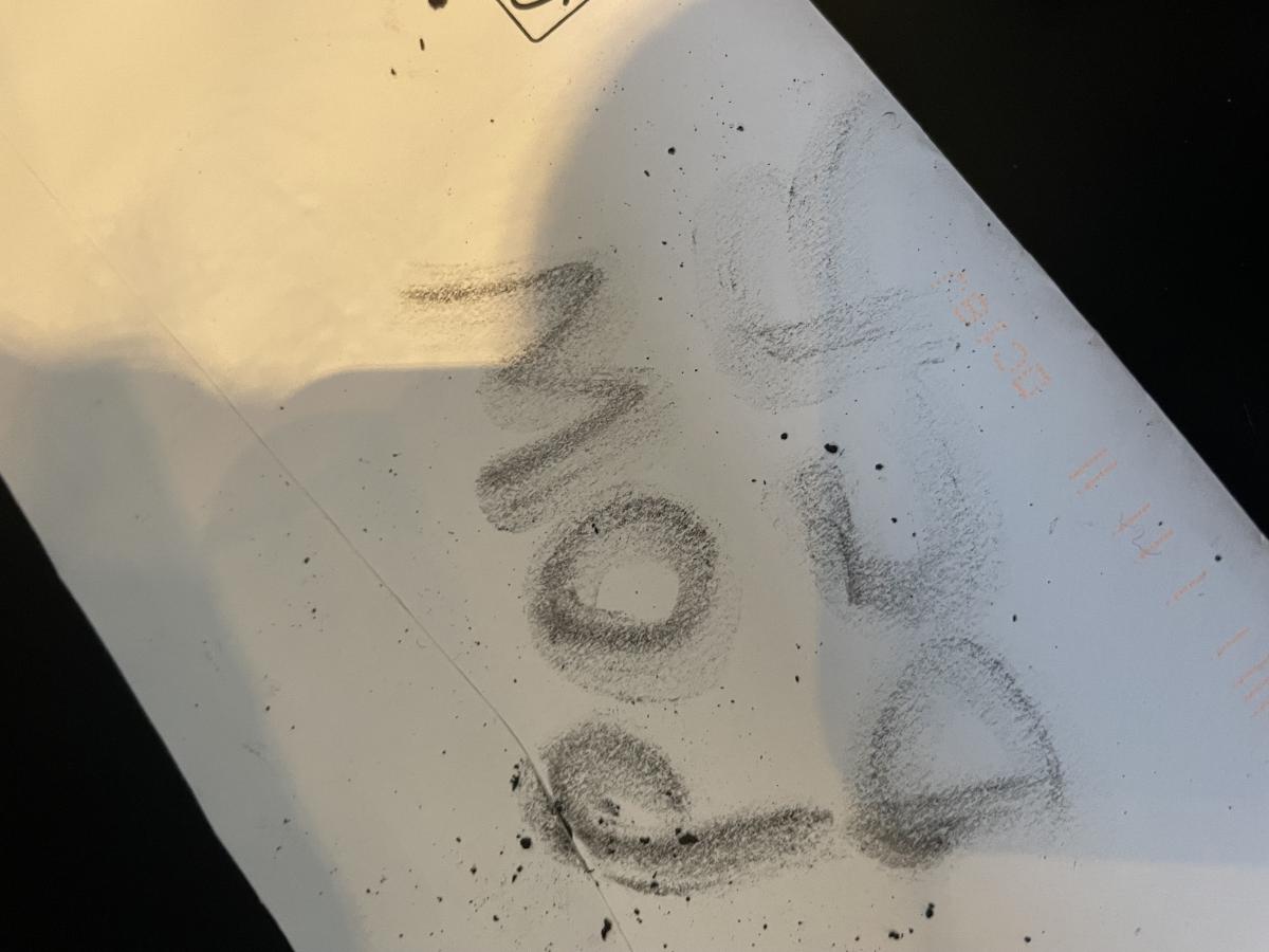

                      Carbon brushes do wear but I expect to see a lot powder collected in there. Pics of the powder?
                        Pics of the powder?
                        Here is the powder (I gave it a couple of taps over an envelope):
                        ​ Click image for larger version  Name:	IMG_4809.jpg Views:	0 Size:	57.7 KB ID:	239580
                        Click image for larger version  Name:	IMG_4810.jpg Views:	0 Size:	76.5 KB ID:	239581
                          I think the power is the collection of worn carbon brushes around the brush holders, which is normal.
