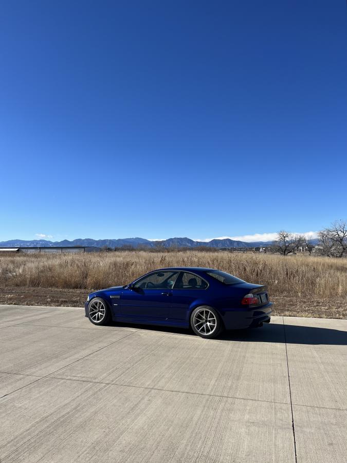

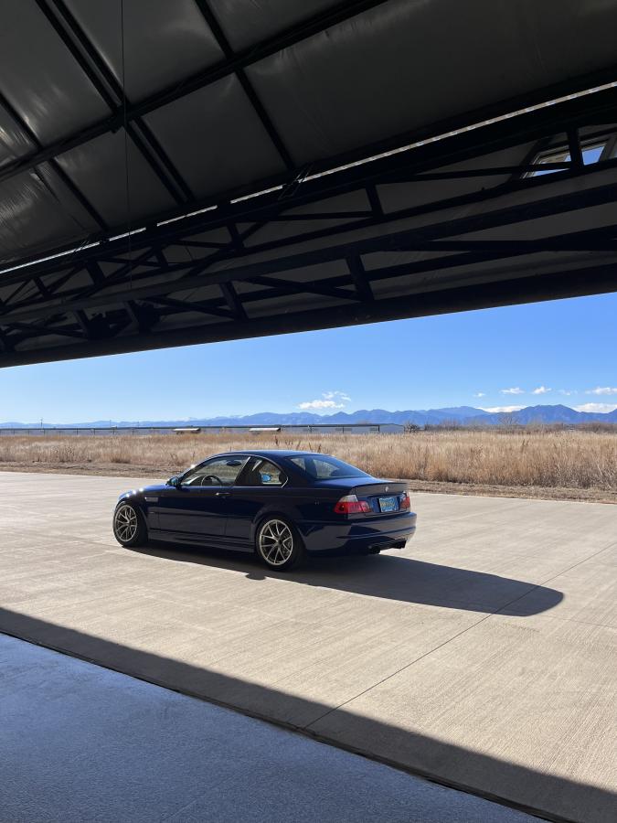

                        For fun —
                        Here’s my car on 18x10.5+22 sq. BBS RIAs, 275/35r18 Kumho V730s sq.
                        -3.0* camber front / -2.2* camber rear
                        They ‘fit’, didn’t experience rubbing lock to lock somehow. As others have mentioned, -3.5* of front camber would really be the sweet spot to get these to fit “well”. My fenders are slightly rolled, but not shaved.
                        Ultimately decided on going 18x10+25 / 265/35r18 sq. I really believe this to be the optimal setup for E46s that see track/canyon time. Past a 265 width tire I’ve found steering feel begins to drop off…many moons ago I ran 285/30 sq. Never again.
