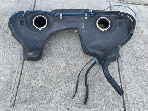

                Thanks for all the help so far. Does anyone have an image or a diagram showing what hose plugs where on top of the gas tank? Something like the following, but with some identification:
                Click image for larger version  Name:	image.png Views:	0 Size:	313.2 KB ID:	237978​
                If not, I am mostly curious about the left side (driver side) of the tank. There are 2 connections there, a blue one to the left, and another one on the fuel sender cover. What is the purpose of each of them?
                I'm mainly wondering if that would be possible that I screwed up and connected the return line to the wrong of the 2 possible places on the left side. This would explain that fuel is being dumped on the left side and not sucking fuel from left to right.
                The way I now understand this is that the return line must be connected on the left side but the returning fuel goes to the right side through a jet pump hose that connects both sides internally (inside the tank). The movement of gas from left to right in this device is what creates the suction to transfer gas from left to right. If the return line was connected to the wrong location, then the jet pump is not doing anything. The returning fuel is flowing into the left side of the tank and there is no suction to transfer any gas.
                The way I currently have it connected is: the leftmost connection in the image is connected to the return, and the one on the left sender / cover is coming from the right side (probably something going to the evaporation charcoal canister - I'm guessing). I'm starting to think it's likely that I screwed up.

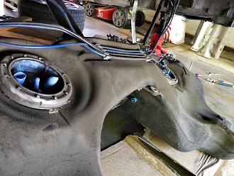

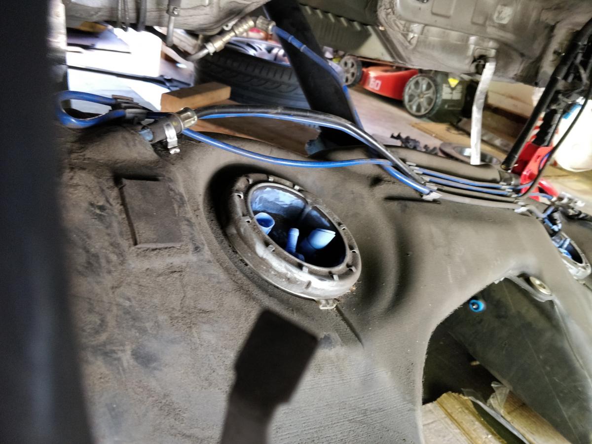

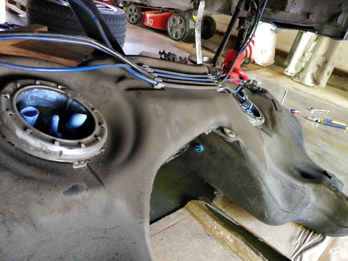

                  Is it easy to connect the wrong line? When I did subframe and dropped it. It seemed pretty straightforward on how it connects.​​​​​ Click image for larger version
ID:	238002 Click image for larger version
                    Thanks. This makes me 95% sure I messed up.
                    If someone can confirm that
                    1 is the charcoal canister (black line going towards the right)
                    2 is the return line (blue line going to filter)
                    This will confirm I have inverted them.
