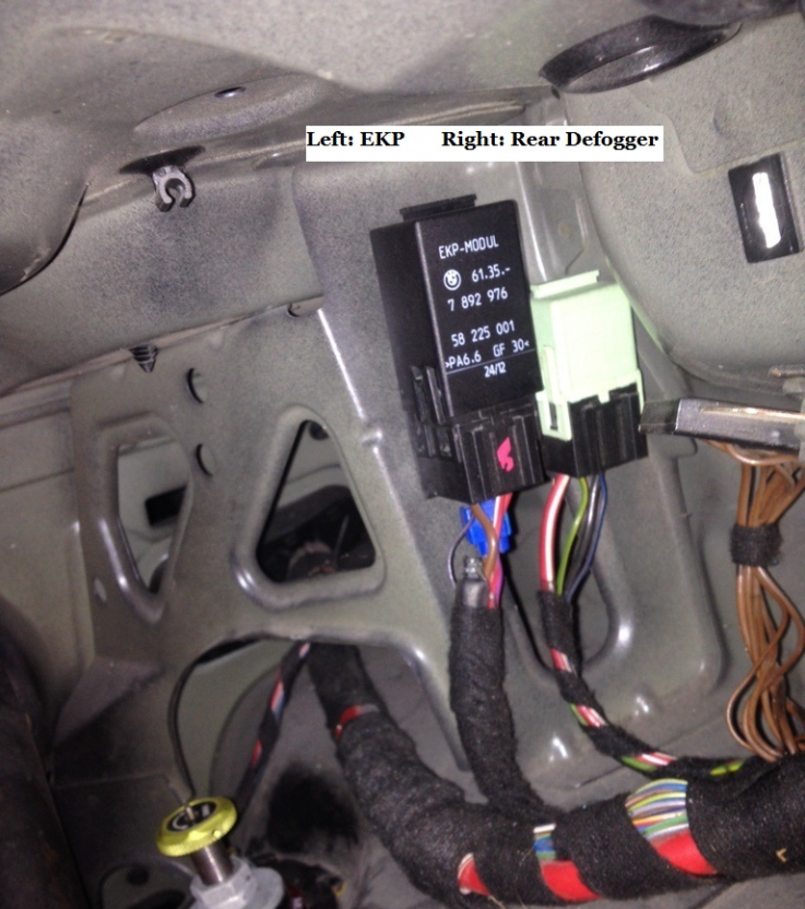

              So I pulled the code through inpa. Got fuel pump relay. So it's a relay problem. Where is it located and where to buy a new one?
                ​It's located in right side of the trunk just forward and up of the battery under the trunk covering (Black relay/EKP).
                Click image for larger version  Name:	image.png Views:	5 Size:	878.5 KB ID:	238192
                  Thanks , I'm going to change the relay and also the pump and filter too.

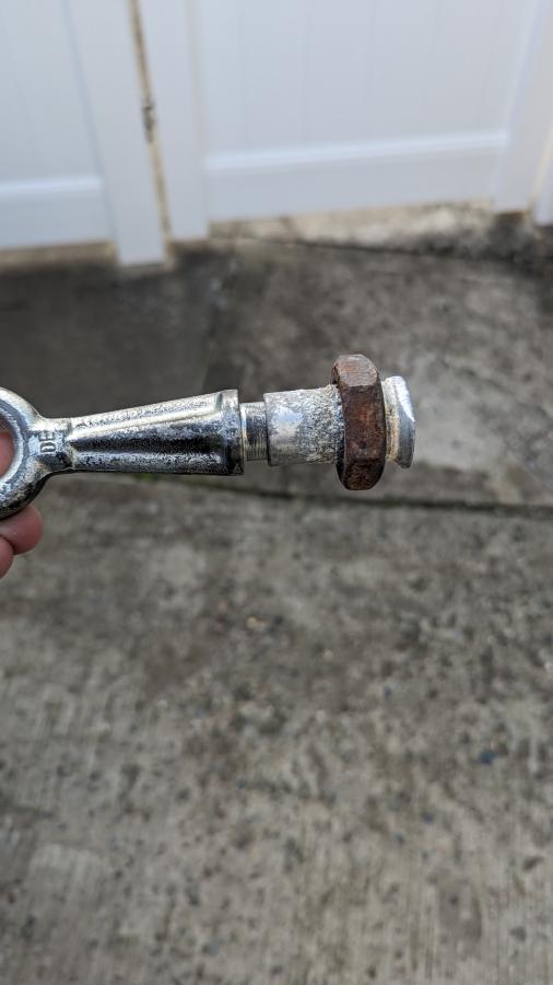

                    Also is this part replaceable the part the tow hook goes into?
                      Have to replace the reinforcement bar. Kevlar bar?
                        Does anyone have a pic of the mount the tow hook goes into, I'm trying to see if it's replaceable. Or have a part # for the mount?
