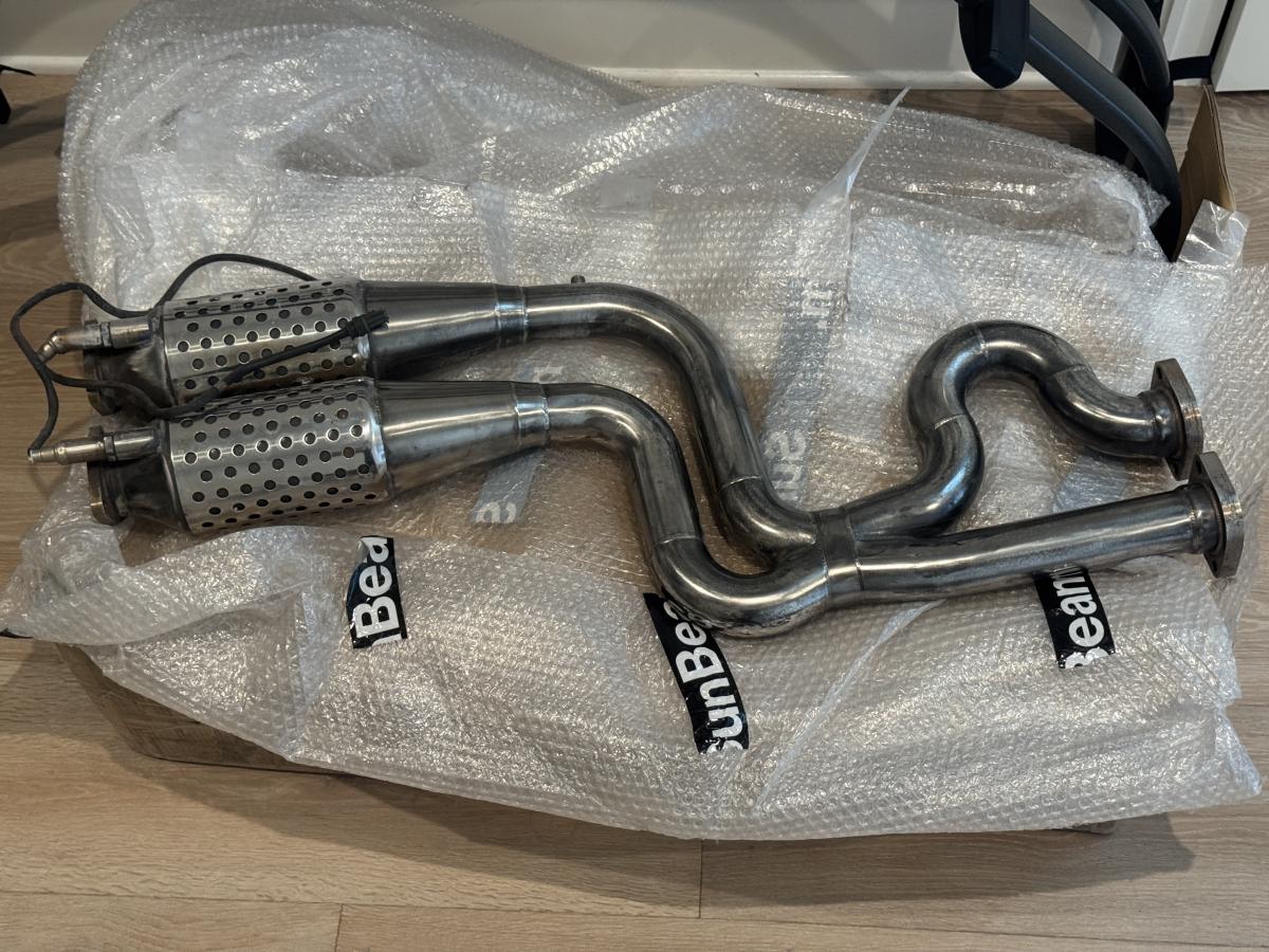

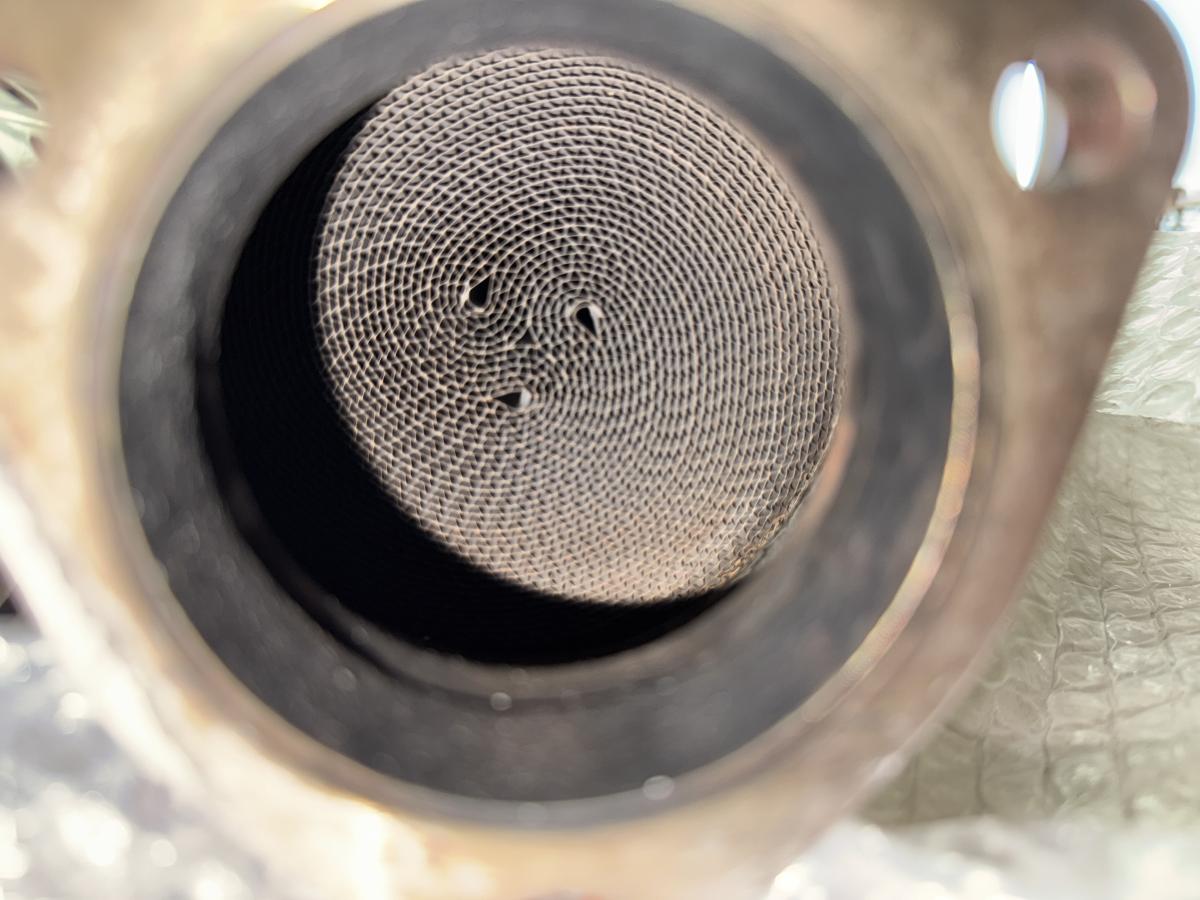

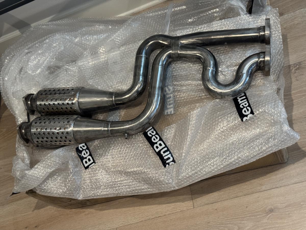

                          Is that a catted Sunbeam EL Sec 1?
                            Saclam is another Japanese company who made parts for the e46 m3. See here.
