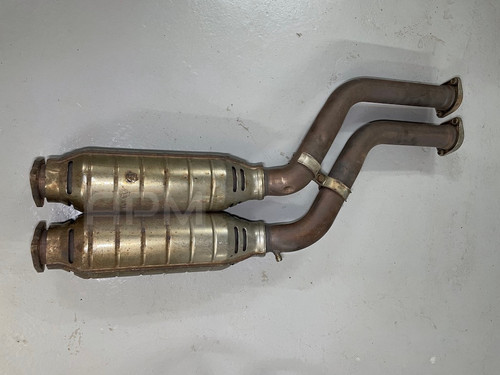

                I’ve yet to see euro cats for sale. Where’s the best place to hunt them down?
                  Apparently they have CSL Sec. 1 for sale but they are quite expensive, look around the site, they may have the non-CSL Euro.
                  https://www.apmotorsport.co.uk/produ...s&currency=USD
                  Edit: 1 in stock
                  Original BMW E46 M3 Euro Cats. Same as CSL Cats. Aprox 50k miles use. Conditon: Used No surchage applied to this system or the need for your old system.
