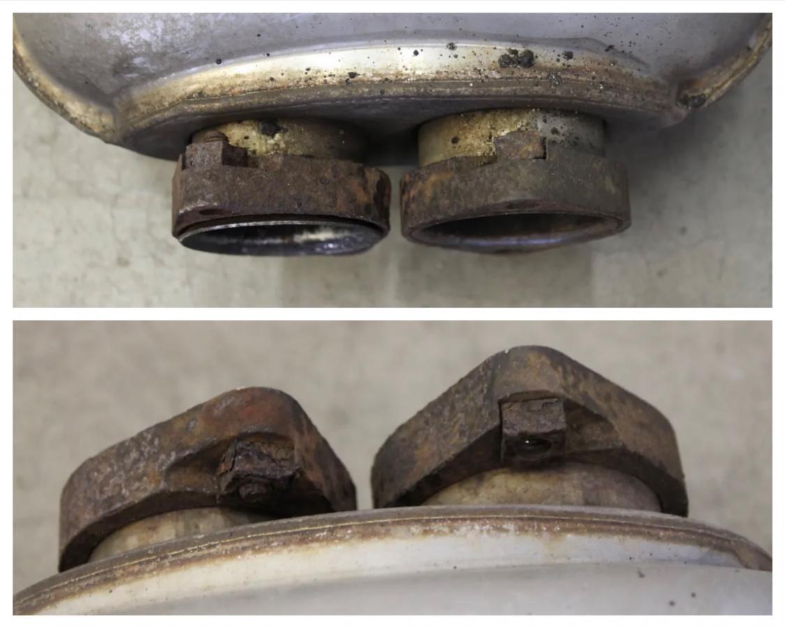

    Hey Group - anyone have a solution for the crusty / rusty section 2 to section 3 connection on the section 3 side?
    My flanges are rusted and the OEM square nuts are frozen to the hardware. There is a broke bolt on one side. I’d love to cut these off and replace the flanges with something better.
    Anyone refresh their section 3 and find a good solution for this crusty connection?
    Thanks in advance
