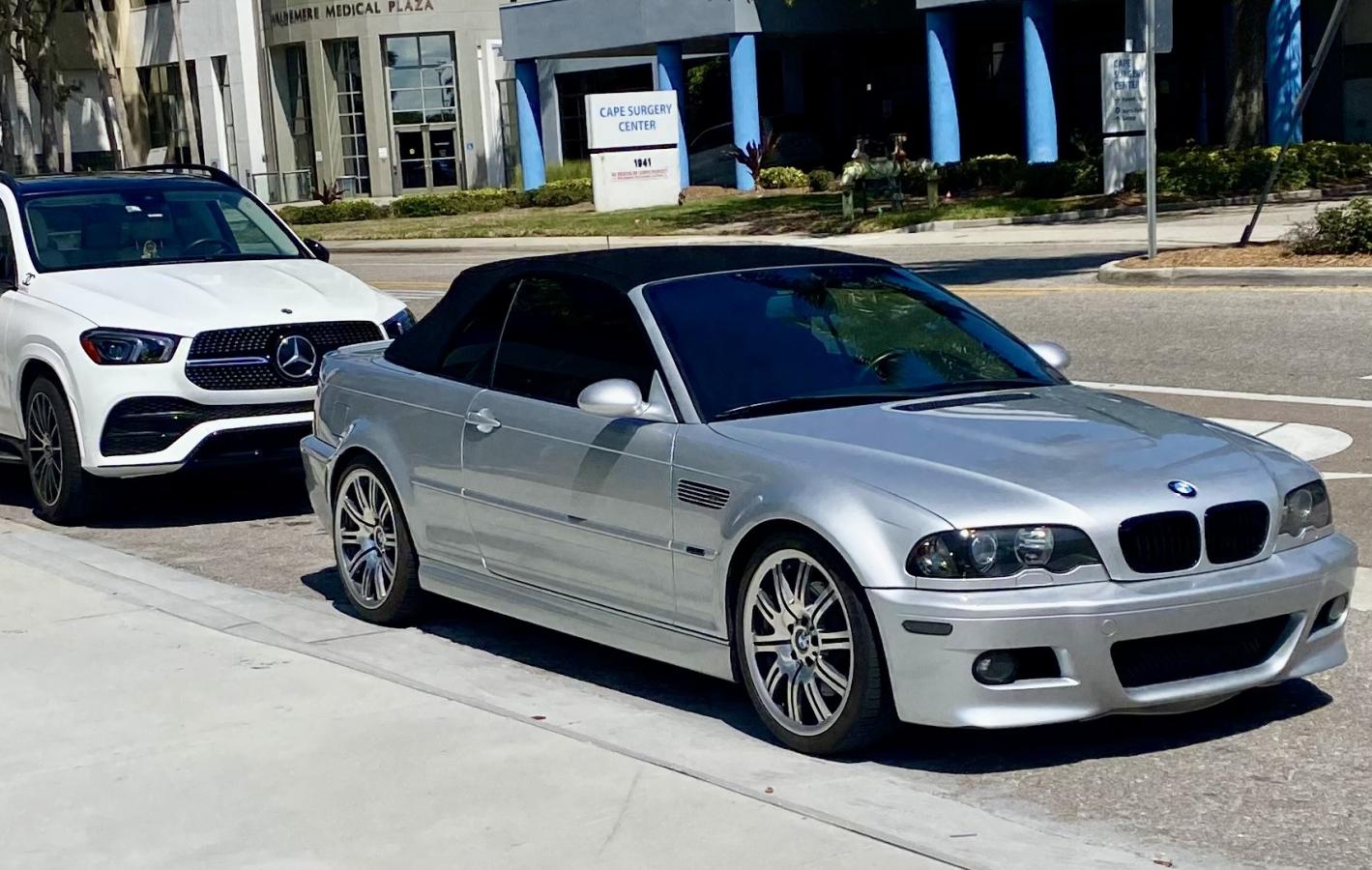

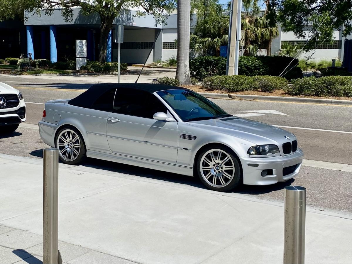

              Mine is "Florida Legal"... probably 20-something in the rear, 30-something on the sides. Garage kept car under a cover, but the FL sun is a bit more extreme than Deigo.

                Minty! Looks beautiful man

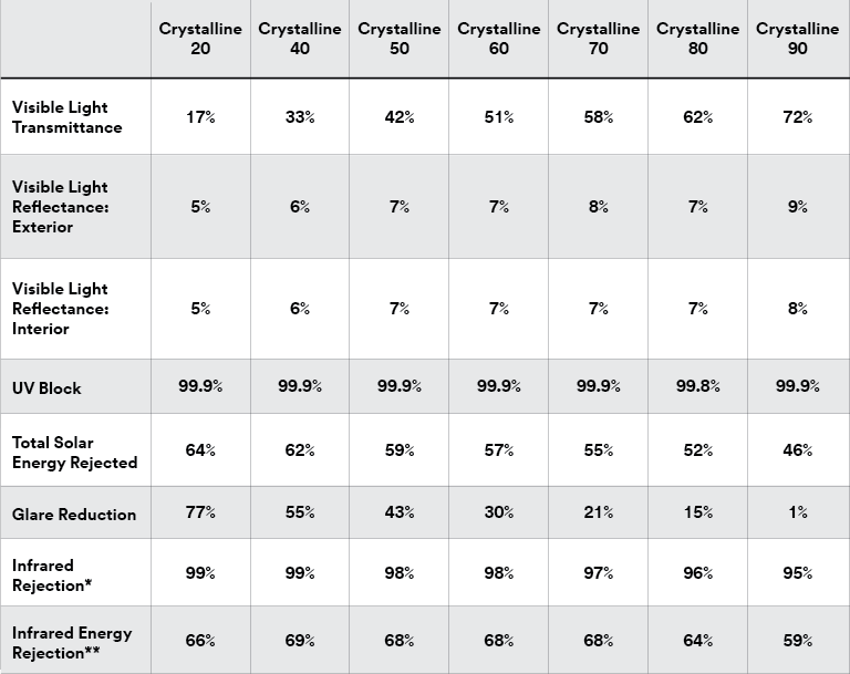

                          Something to keep in mind regarding to what most people are talking about when they mention percentages which is visible light transmission (VLT). This number has very little to do with "protecting" the interior. There is a common misconception that you must go darker to achieve greater protection in terms of UV, infrared, and solar energy. This is simply not true. Going with a darker tint has more to do with VLT and glare reduction.
                          As you can see from the chart below, 20% to 90% tint provides 99.9% UV block, 20% delta in solar energy, and only a 5% increase in infrared rejection between 20% and 90%. Most ceramic tints offer this type of protection, so this is not assumed for all types of window tint.

                            Amazing explanation and chart, thank you for this 🙌

                              Absolutely, no problem at all! I wouldn't overthink it too much though. With Carbon Black on Black leather, lighter window tint is actually going to look darker on your car due to your exterior paint but also more importantly your interior. Black interior doesn't reflect as much light as lighter colors so a 35% tint will look more like 30%.
                              I would say if your eyesight is really good, go with 20%. It's funny because when the suns out, darker window tint actually helps you see better since glare is drastically reduced. However, if it's raining or very dark without street lights, your visibility will be very poor the darker you go. All that said, you live in LA...plenty of lights and sunshine. I would run 20% on sides and rear, and 80% on front. You almost have to run tint for blk/blk imo
