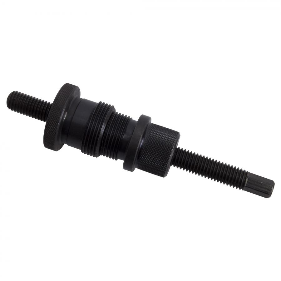

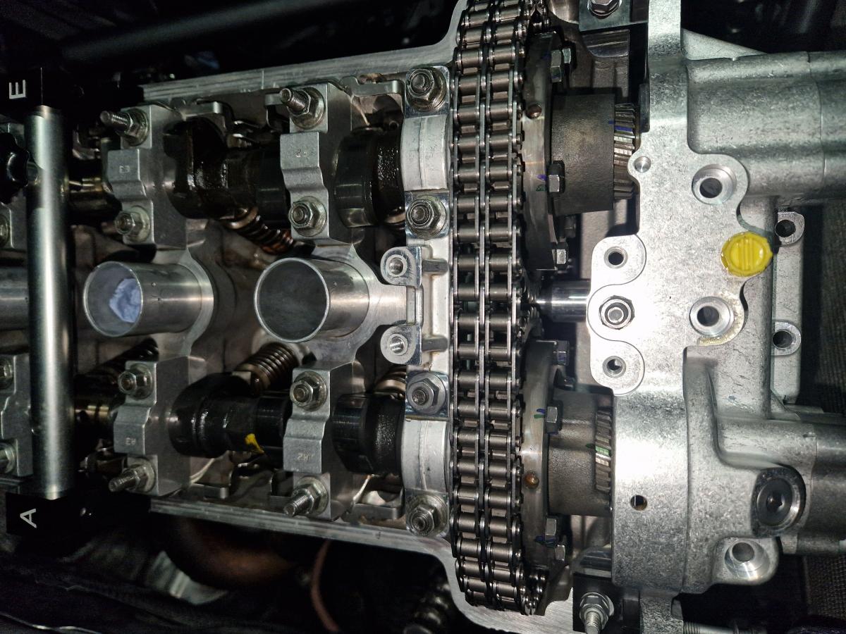

              1) I checked the VANOS timing this last time with a chain tensioning tool, to avoid that the lack of oil pressure could change the timing.

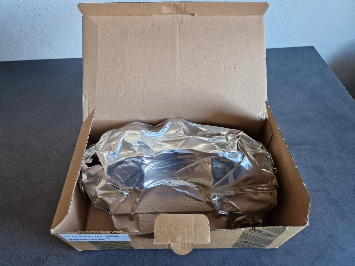

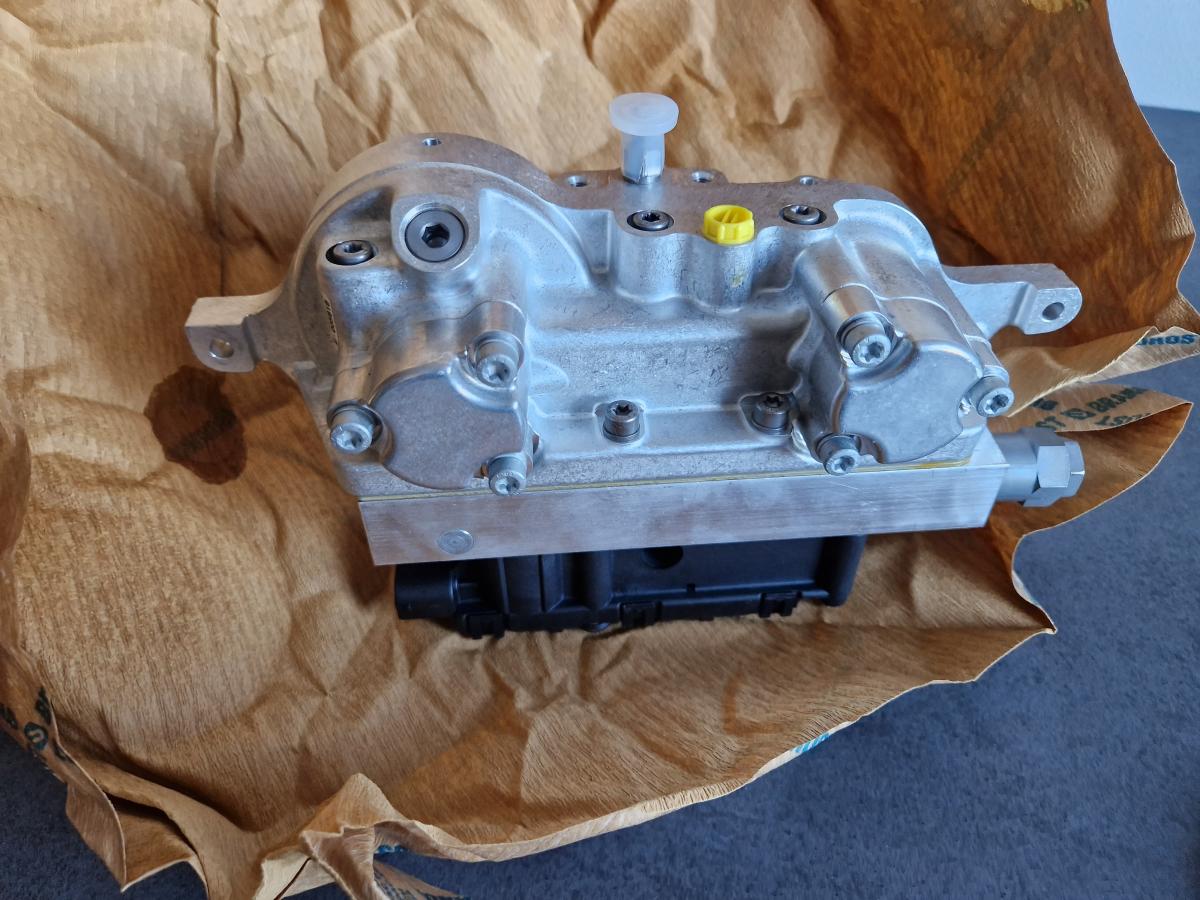

              2) Hydraulic unit I mean the vanos itself. I made first seals again, but in the end I replaced the whole VANOS (in case it was losing oil pressure inside):

              and as you rightly say, I have changed things that make no sense, because they worked before and have only been disassembled and reassembled... ๐Ÿค”๐Ÿ˜ฐ

                Where did you source the new unit from?
                  Check the hub diaphragm springs and that they are not flipped, this would cause the unit to lock. n would also suggest to not use the S62 items and go back to S54.

                    I bought the vanos on ebay, but it was brand new and sealed:
                    The first few times I assembled it with the S54 springs, and the last time I ordered the S62 ones. I will order bouth new off S54 again, but I'm afraid it won't be the solution...

                          1) I checked the VANOS timing this last time with a chain tensioning tool, to avoid that the lack of oil pressure could change the timing.โ€‹
                          Nothing is wrong with using new parts, but I think it's better to find the root cause and not blaming the old parts.
                          After setting the vanos timing, how do you verify the timing is correct?
                          Turning the crank CW multiple turns and set to TDC, then verify the cams holes are aligned with the bridge pin. But this alone is not enough as the vanos pistons must be touching the caps too during the timing check.
                              You are right again, Sapote. I don't like changing parts without being sure, but I couldn't find any more logic for my problem...
                              I have done all the steps you say, but it is true that in the end I did not remove the covers to check if the pistons were in their most rearward position. I'll do this on the weekend!
