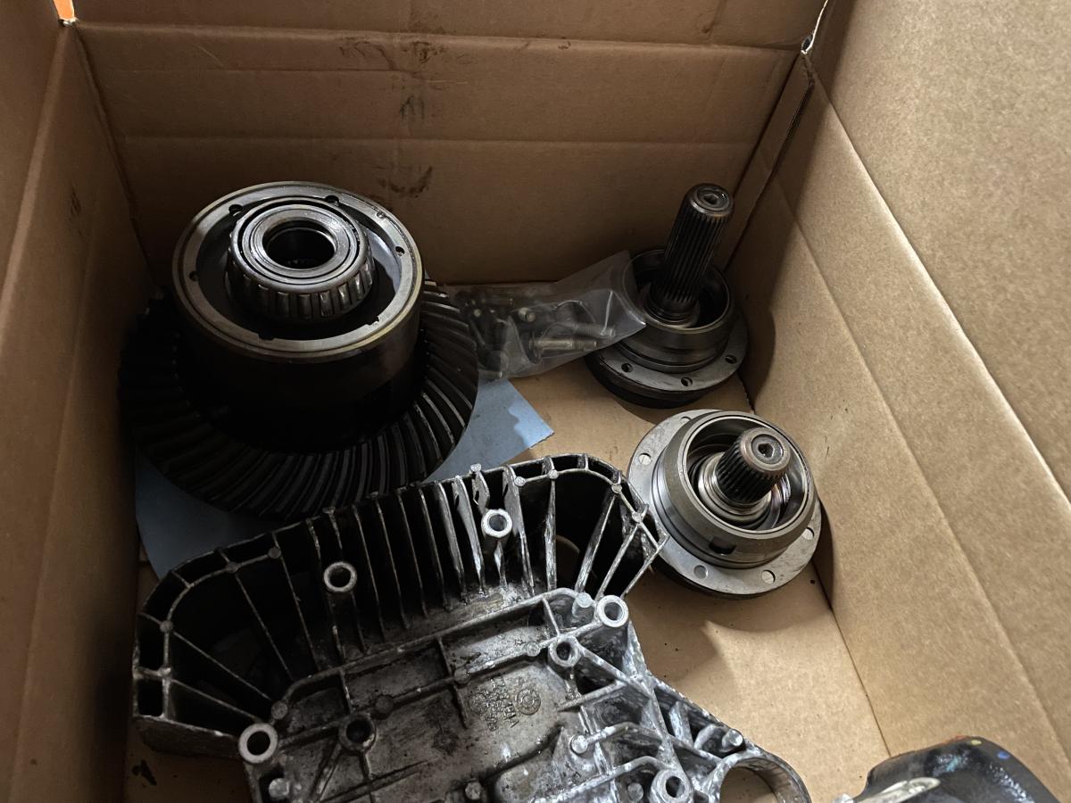

                        I am starting my diff rebuild and had bought a spare to avoid downtime and take my time. What a surprise to find a V2 diff which are kind of annoying to work with.
                        anyone has a tip to open the V2 without mangling the metal much?

                          Its left hand thread. I used the racing diffs tool...still a pain in the ass. Swapping the LSD units is easy. The pain is the pinion gear.
