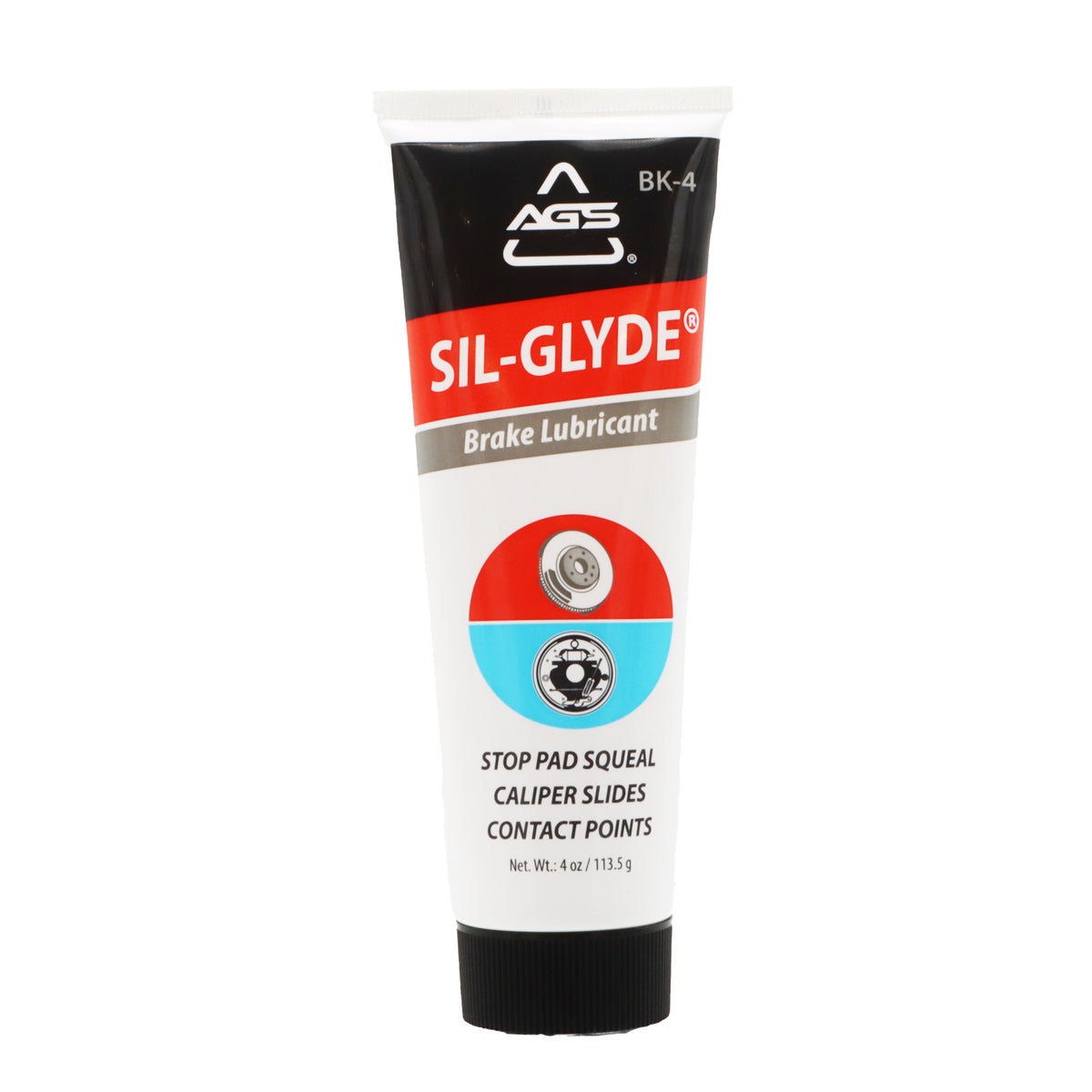

        I’ve always use this:
        Stop brake squeal for good: Sil-Glyde® silicone brake lubricant resists 425°F heat, seals out moisture & won't harm rubber seals. 4 oz tubes to 1000-ct shop packs.

                  I use and recommend Sil-Glyde Silicone Brake Lubricant. https://www.agscompany.com/products/...rake-lubricant
                    Another vote for Sil-glyde!
