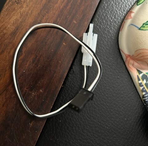

    The kit came with the plug shown in picture. There is no place to connect it inside the assembly, and the DIY video showed reusing the OEM plug. That's the only thing I can think of.

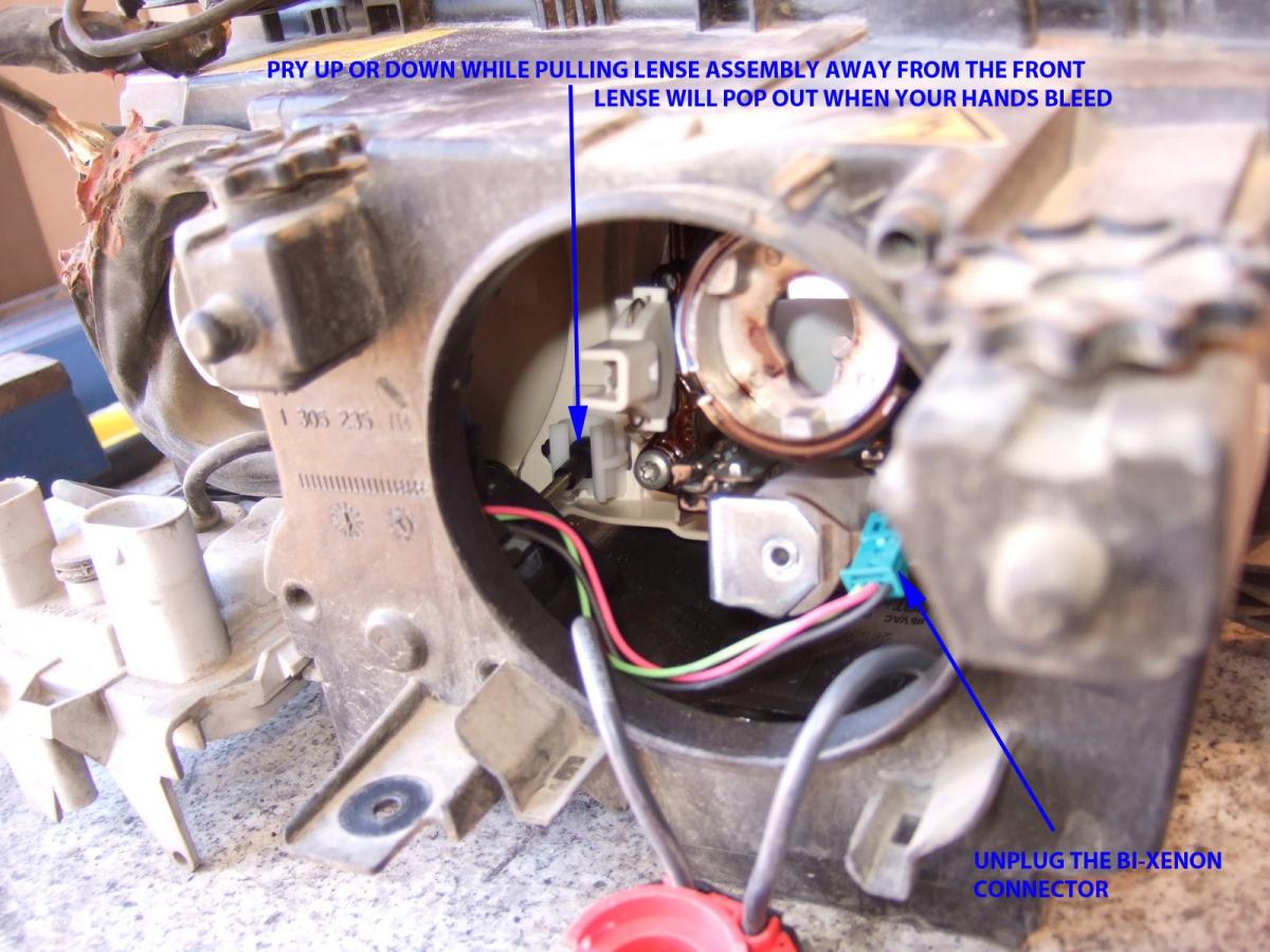

    Your headlights should have a group of red/black/green wires that operate the shutter, looks like the wire you pictured may connect to this and then to your projector, assuming the replacement projector doesn't have a factory plug.
    The factory system uses a 3 wire system, with a strong initial signal to pull the shield, then it reduces the voltage to save burning the factory solenoids out, but most (if not all) aftermarket projectors use standard 2 wire 12v for the shield.
    ​​​​​​Not my picture​, but can see wire with turquoise connector.

      Totally with you and thanks. But there is no way to connect the provided plug into the OEM plug. And their DIY video shows plugging the OEM plug directly into the replacement projector. And why would I lose high beam on the driver side, with original projector? I'm going the check codes.

          To clarify - I lost high beam on both sides, after just replacing pass side projector. Yes the OEM plug fits - the connector provided with projectors (pictured) does not. It goes from 3 pin to 2 pin with no place to plug in. Trying to reach RetrofitLab today.
