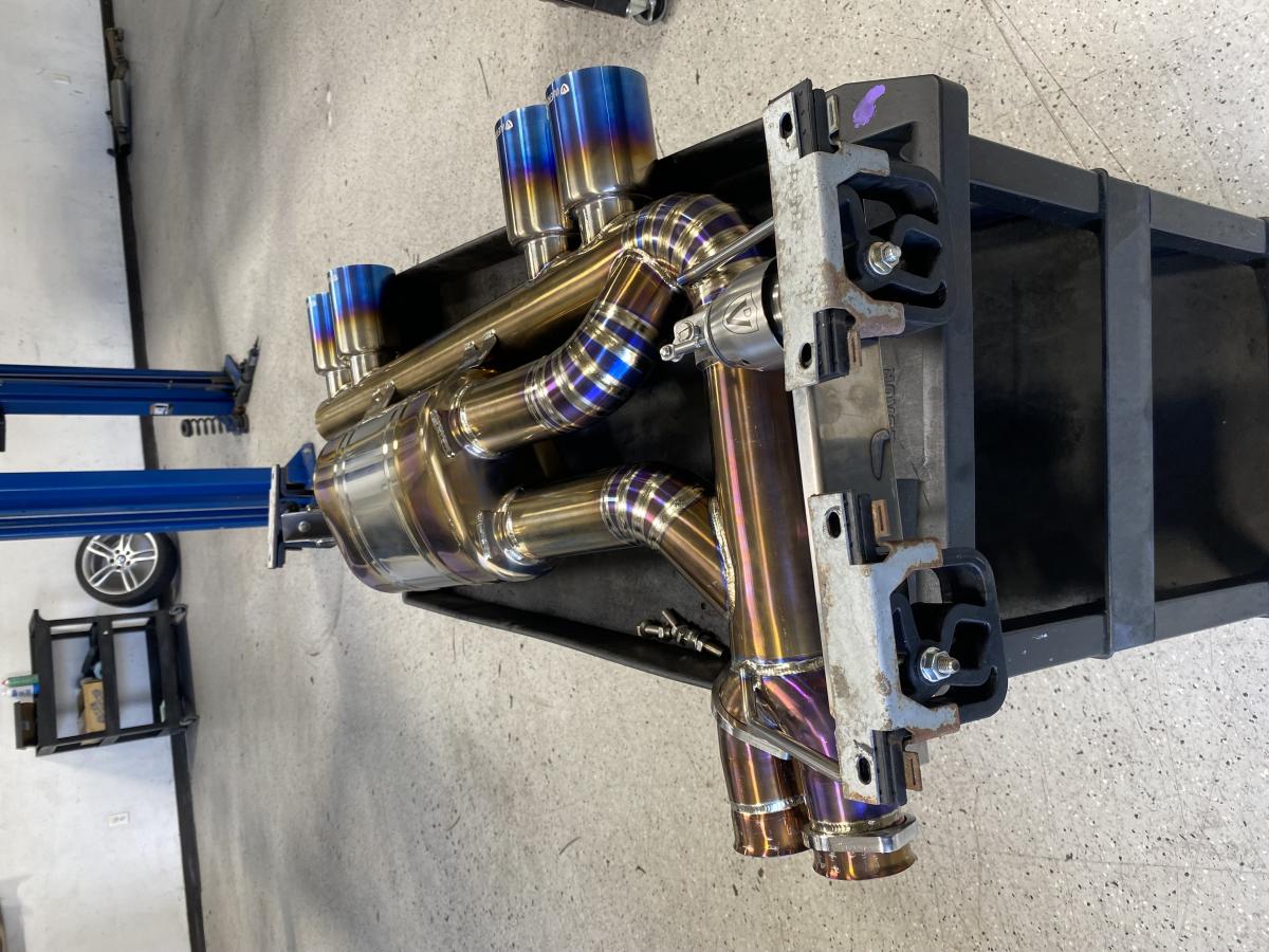

                      I have the Ti variant of the muffler. I can share my experience after about a year of ownership since it was not perfect.
                      Bad
                      Fitment wasn't too great. Both OEM and CSL-style diffusers will make contact with the 3" tips. I ended up shaving the inside of the CSL-style diffuser. Also, the driver side tips stick out slightly more than the passenger side. When installing, you should be sure to rotate the passenger side exhaust hanger such that it holds exhaust closer to the outside of the car. I also had the passenger side hangers bent slightly to improve fitment. With the OEM section 2, it should mount up fine. With the SuperSprint twin pipe, part of the section 2 will need to be cut off in order to mount the muffler.
                      I had drone at ~2500 RPM with OEM-like (additional resonator welded in the OEM section 1) and my current SuperSprint (V1 headers, catted section 1, resonated twin pipe) setups. Its worse with the valve closed unfortunately from my experience. With the valves open, its significantly less noticeable. I'm scared to track it with the valves open because of dB limitations but valves closed was perfectly fine.
                      Good
                      The sound is incomparable to anything I've heard in both OEM and SuperSprint setups. Tips look sick. Valves closed is still loud but much more civilized than with the valves. When the car is shut off, the valve will leak and slowly close which is nice for my neighbors when I cold start it and forget to close it. Also, the controller can be paired with your HomeLink buttons (open and close will take up 2 of 3 buttons) so keeping the remote in the car is optional.
                      The exhaust itself looks pretty good.
                      Click image for larger version  Name:	IMG_6510.jpg Views:	0 Size:	164.3 KB ID:	245722

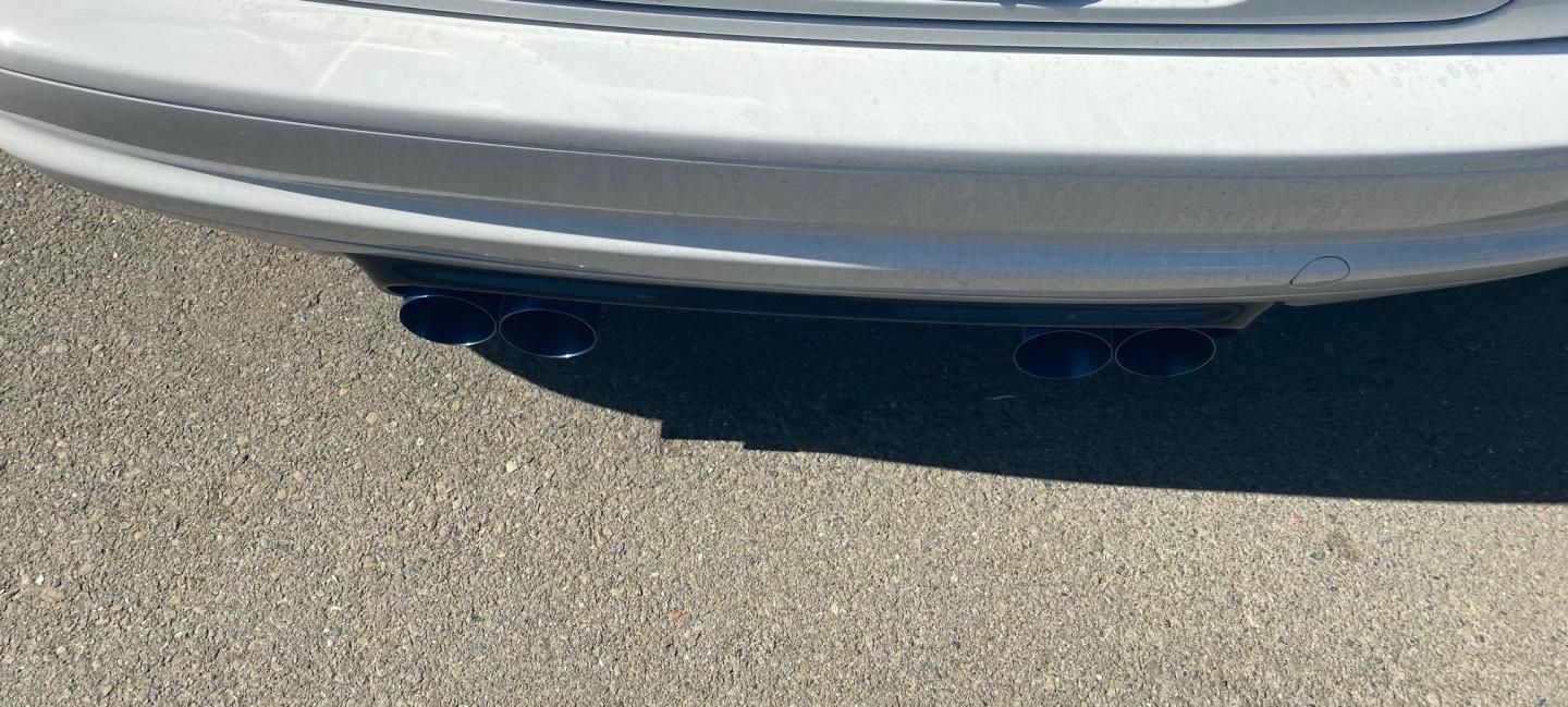

                      Final fitment after all adjustments. Still not perfect. Sorry about the lighting but you can see the driver side extends noticeably further out still.
                      Click image for larger version  Name:	IMG_0197.jpg Views:	0 Size:	194.1 KB ID:	245723
