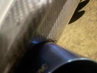

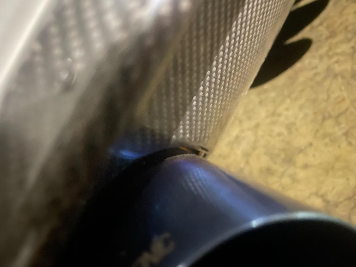

      On the inner sides. Top clearance and outer sides are both good despite the 3" tips. There is a bit of lip behind that part of the diffuser that needed to be trimmed in order for the tips not to rub. At least it won't be visible. There is space between the tips and the outer sides so if the tips were spaced the tips outwards maybe 1mm, they possibly would have cleared it. Here's a picture showing how close it .

      I never tried to fit the section 2 with any other muffler for comparison if it was a problem with the section 2 itself rather than the muffler, but about an inch off the longer exit needed to be chopped off in this picture.
