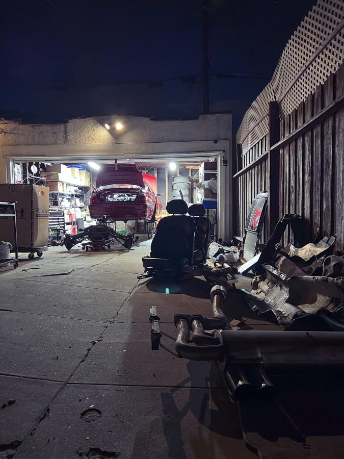

    One other thing, my driveway is actually too narrow for a truck to get in the gate and back to my garage, I don't know if that matters or not but the gear would need to be wheeled in like 50 feet from the gate to the back of my house. Located in Marina Del Rey specifically.
