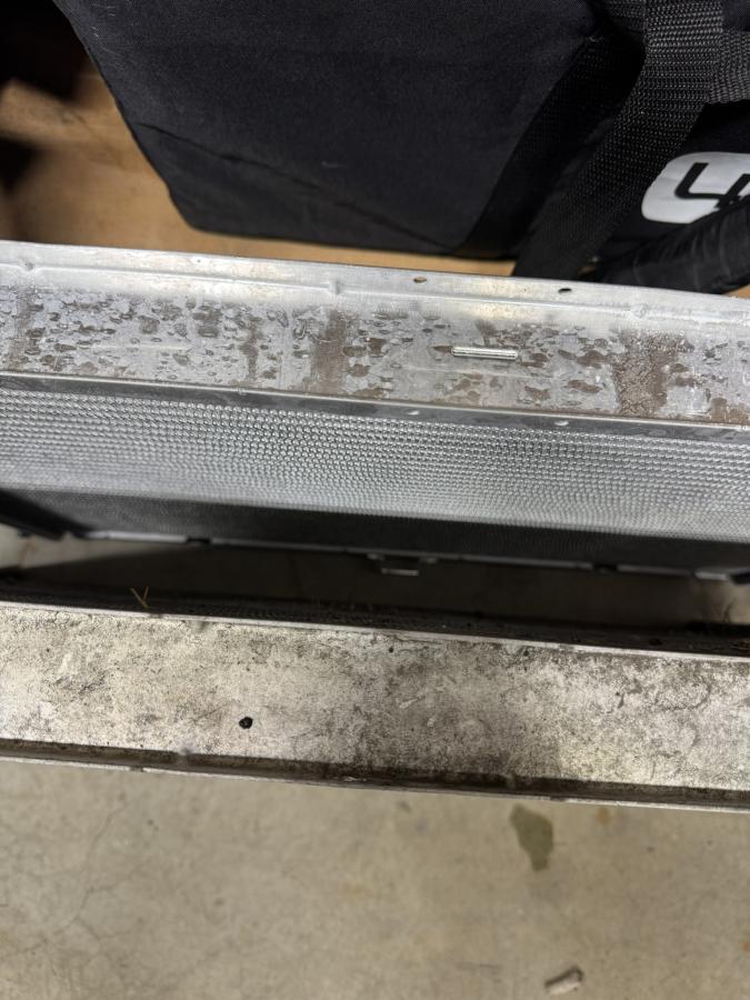

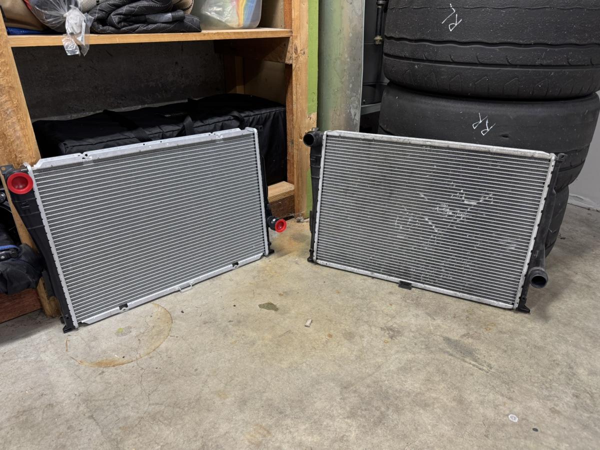

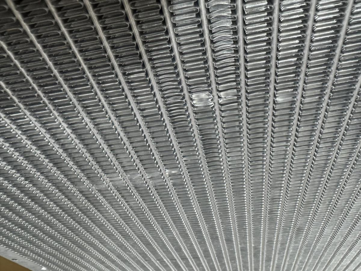

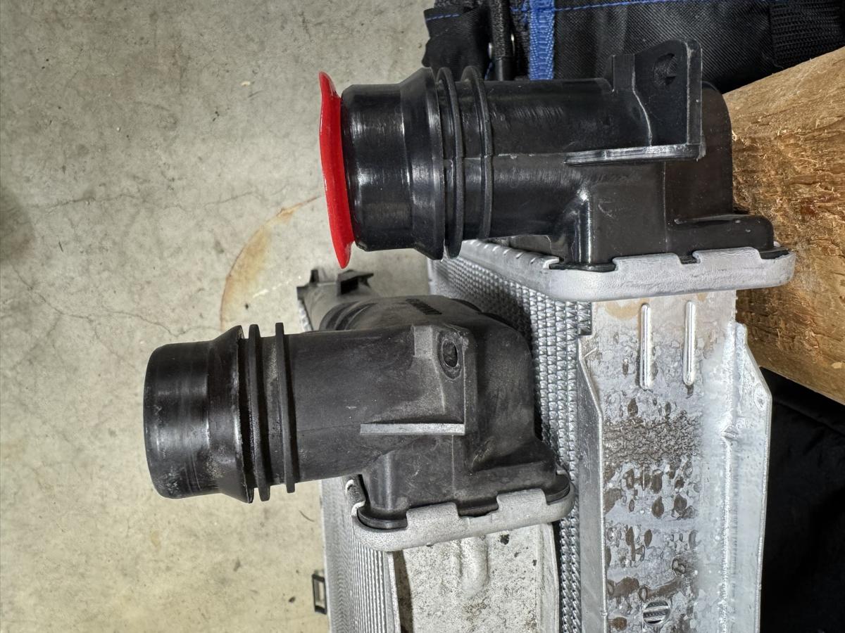

                          After reading this thread, I ordered the Modine marked OE from FCP Euro. I received an NRF box, with what I feel to be a marginally worse than OE part inside. Specifically, the NRF radiator:
                          • uses a different type of plastic than the genuine BMW unit, that feels poorly casted and cheaper
                          • is noticeably lighter overall (I made sure the original radiator was completely empty before making the comparison)
                          • is a few mm thinner
                          • has a metal fan bracket attached with pop rivets as opposed to the plastic
                          • came with several bent fins (though otherwise appears to be brand new)
                          Here are some pictures showing the two side by side. The NRF unit is probably fine, but definitely a step down. For me personally, I'm going to splurge for a new genuine unit, or maybe even the do88.

                            +1 to uberchris sentiment. I wish I had gone with Genuine.
                            The fins are very soft in comparison, and I had fitment issues.

                              Wouldn’t have made a difference, you get the same thing, we concluded that in another thread on this forum.
