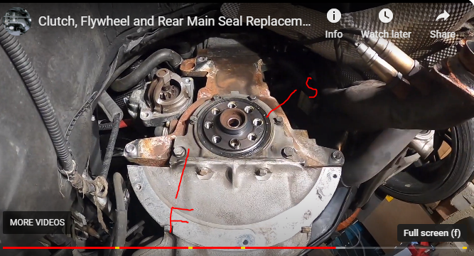

    The normal way is to remove the seal frame F off the egnine block, then remove and replace the old seal S, then install the frame with new seal back to the block, and new U shape gasket and add some sealant on the oil pan lip.
    But why not just leave the seal frame alone and pry the old seal off and install the new seal without removing the seal-frame? This would avoid disturbing the oil pan gasket and not need to replace the U gasket.

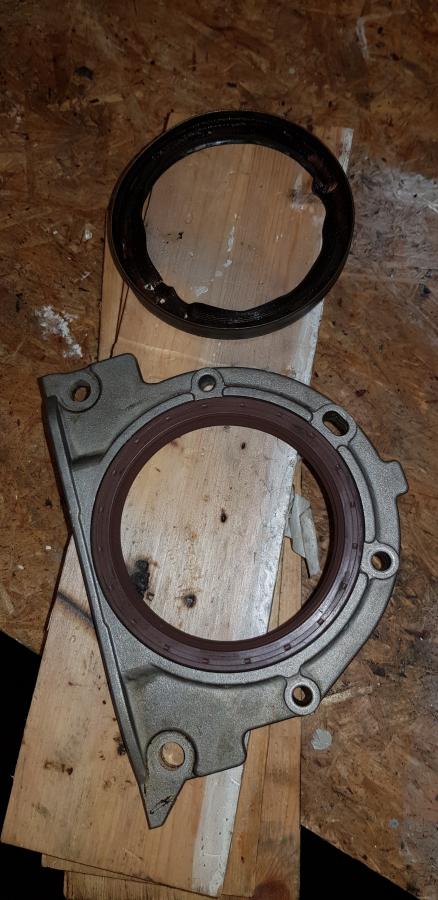

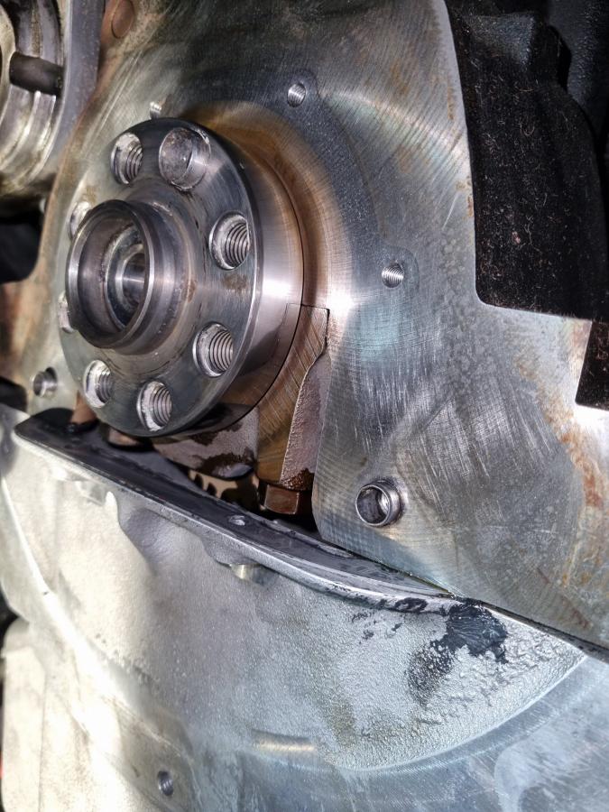

      I did this.. And it leaked... Would not recommend. Though I will say that when I fitted the pure seal alone it was the old style, and I still removed the frame (I forget which seal is which, I believe the old is with the internal spring at the back), whereas when I swapped the whole frame with the seal preinstalled it was a newer style springless seal. I also polished the crank and applied thread sealer to the bolts as well as ample sealant for the u-shaped gasket and the joint for the oil pan.
      Removing just the seal I see plenty of people use 2 wood screws either side and manage to pry it out relatively cleanly that way. If you choose to fit just the seal I would recommend getting the newest style, as well as you can get a plastic tool to help you fit the seal over the crank without disturbing the lip.
      Just the seal that leaked

      Polished the crank with a dremel

      Forgot but probably the "new seal" fitted to the old frame. Click image for larger version

ID:	247258 And the new seal fitted in a new frame, IMO worth it. With the plastic tool for installing.

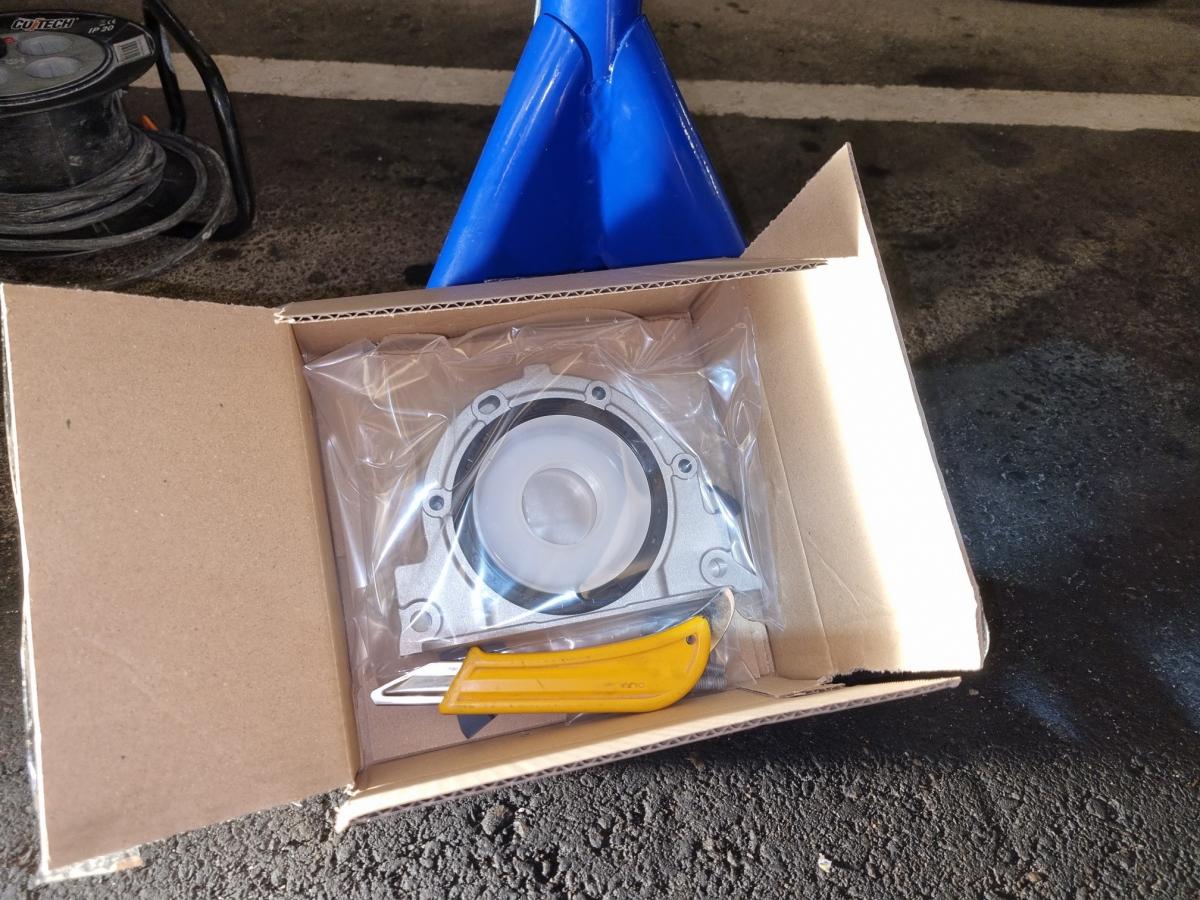

          Yes, I will use the sheetmetal screws to pull the old seal out. The seal I bought is Corteco PTFE teflon seal with no spring which requires install dry no oil. It came with the plastic guide for protecting the seal lip.
                      Click image for larger version  Name:	image.png Views:	119 Size:	454.3 KB ID:	247230nee​
                      Is this the vid that you snagged that screenshot from?

                        Yes.
                        Btw, no need to remove the whole drive shaft off as in the video he did. Just remove its front off the guibo as hang it to the side while removing the tranny. One needs to drop the CSB off the mounting studs, then slide the front half shaft rearward -- the splices telescoping into the rear half -- then it will be off the guibo. Trying to pull it down without sliding it rearward will damage the guibo. Then use shoe strings to hang the rear half up to avoid damaging the rear CV joint.
