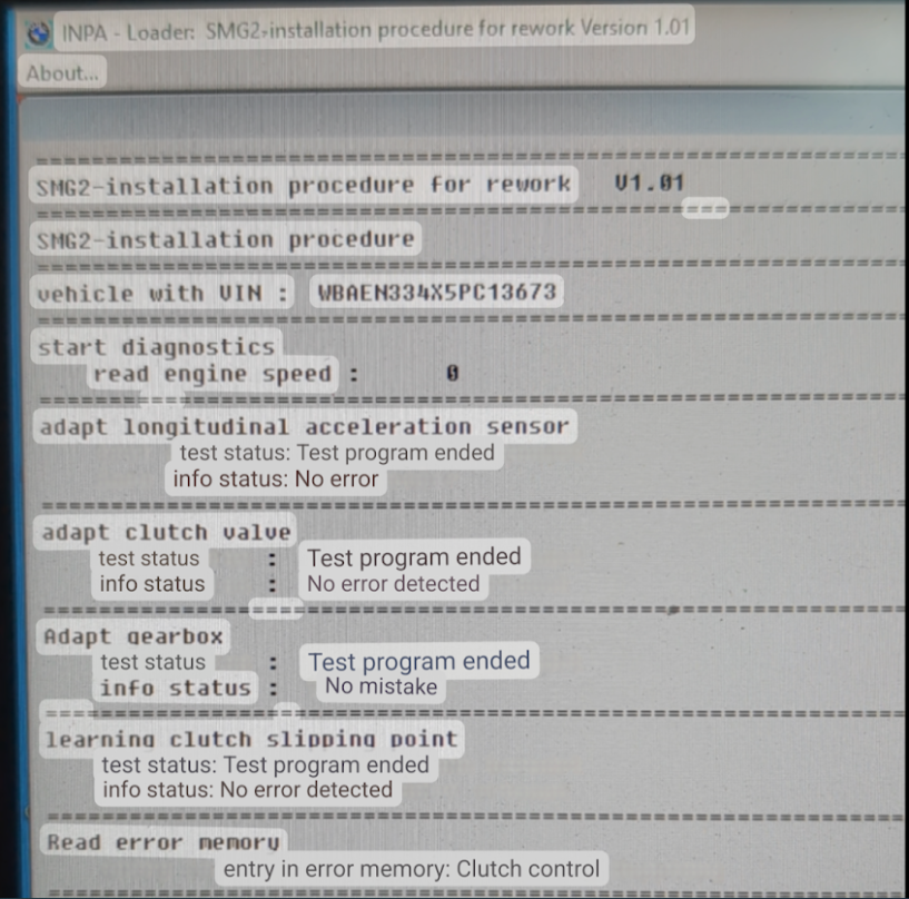

    Able to use INPA to run the bleed actuator test, clutch bleed and the third test for the gear position and clutch control.
    The very last thing in the third step is to press the brake and start the engine which it does but it fails with a red screen that says clutch control

            This might be an issue. I think the purpose of that last step is to measure the clutch bite point with the engine turning and usually only takes a fraction of a second after the engine turns over to go green.
            The fact that all the previous tests pass is a good sign, when I've had failures with the clutch slave they have failed in the clutch bleed adaption.
            I'd say button the rest of the car up and try again. You can still access the clutch slave with the driveshaft on.

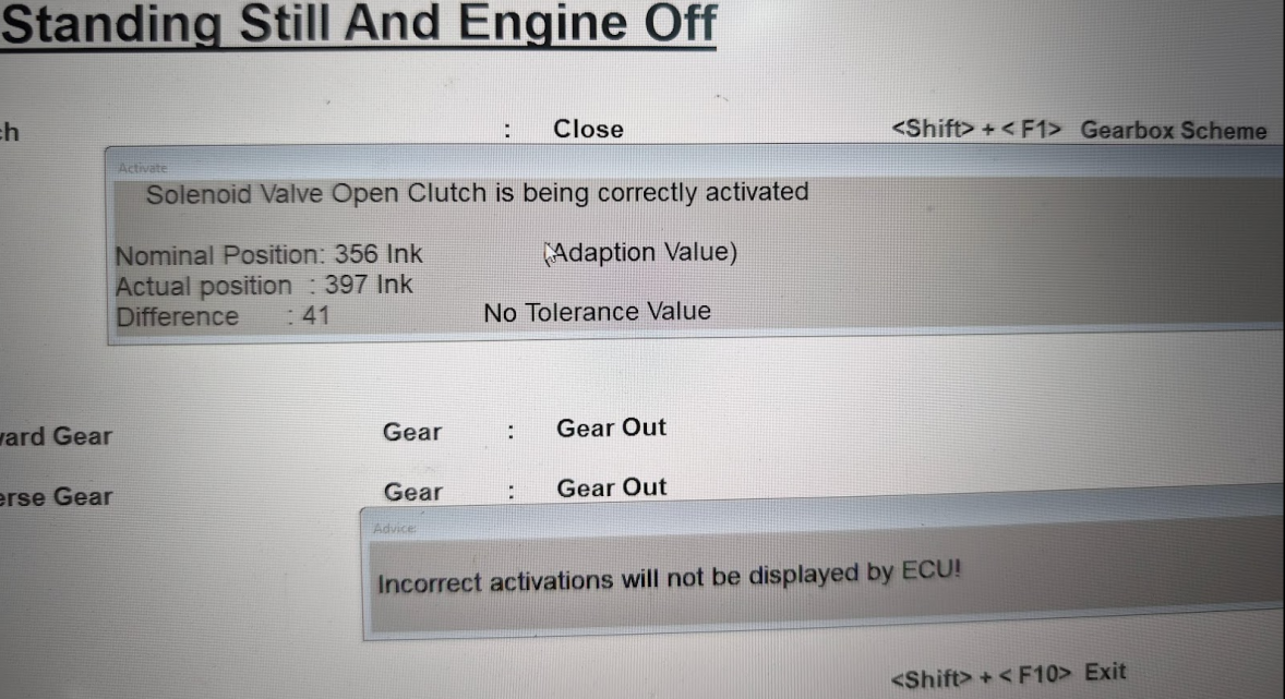

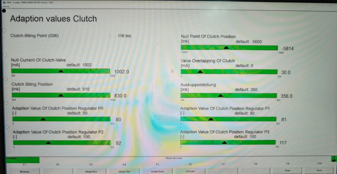

                here are some screen shots from INPA. i even used the activate feature to activate the clutch solenoid to get the readings. not sure how to interpret the actual vs nominal reading.

                            The car is up in the air on quickjacks. That's how I can put it in first second gear and reverse and see the wheels spinning in the different gears
                              can you drive it? If it has no problem driving, then the issue is about testing setup.
