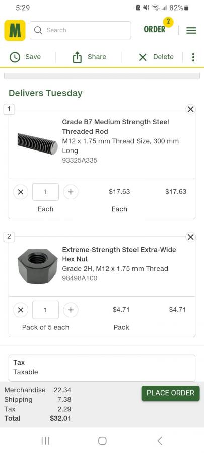

    I also used a threaded rod and bolts from mcmaster.com to remove and install the new outer upper and lower ball joints and sdw rtabs. I have plenty of different sized sockets and washers to use to press the old and new ones in and out.
