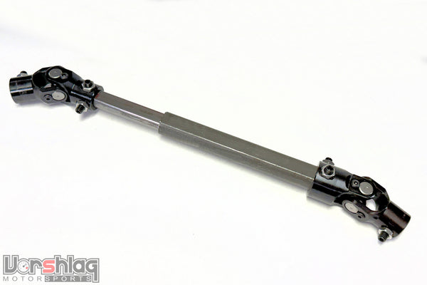

                  Vorshlag also has one. Don't know anything about it, except it is more expensive than the LPSR one.
                  This cart entry is for Vorshlag's BMW E46 Competition Steering Shaft Assembly. This can be used in engine swaps as well as BMW-powered track built E46 cars. Assembly includes custom spline ChromeMoly Steel low profile needle bearing U-joints at both ends and a 2-piece collapsible double-D shaped intermediate shaft. Thi
                    https://vorshlag-store.com/collectio...shaft-assembly

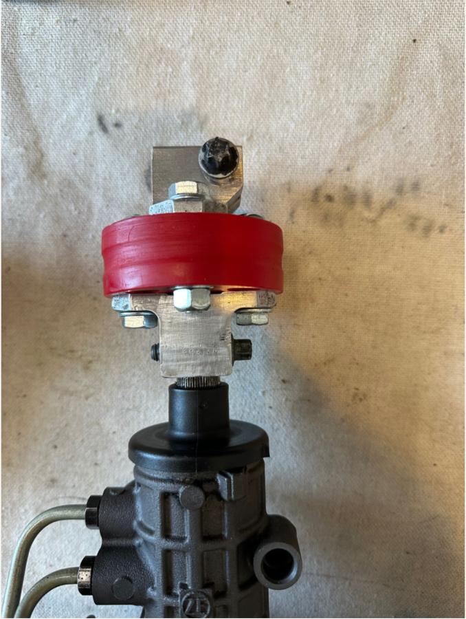

                              I have a OEM coupler with a urethane insert from Ireland Engineering. To me it is an upgrade. Click image for larger version  Name:	IMG_2491.jpg Views:	0 Size:	89.1 KB ID:	325401
                                IMO this is one of the most dangerous things I see people do. Urethane is not the correct material for this. A client with an E28 had a poly coupler (probably from IE as he had bought a bunch of stuff from them in the past) and it failed causing him to lose all steering. Luckily he was pulling into his turning into his neighborhood, so he was able to quickly stop it, but it could have been very bad.
