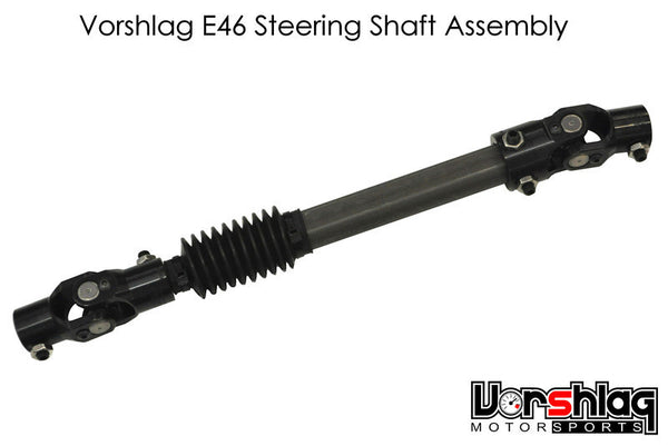

Vorshlag also has one. Don't know anything about it, except it is more expensive than the LPSR one.
This cart entry is for Vorshlag's BMW E46 Competition Steering Shaft Assembly. This can be used in engine swaps as well as BMW-powered track built E46 cars. Assembly includes custom spline ChromeMoly Steel low profile needle bearing U-joints at both ends and a 2-piece collapsible double-D shaped intermediate shaft. Thi
Originally posted by elbert View PostVorshlag also has one. Don't know anything about it, except it is more expensive than the LPSR one.
https://vorshlag-store.com/collectio...shaft-assembly
