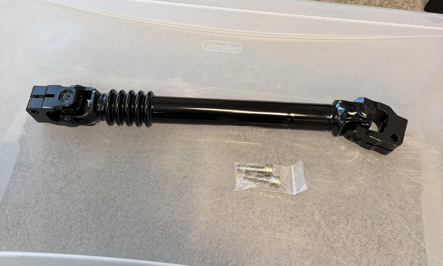

                  I ordered one and it arrived quickly. I haven’t installed it yet.

                    Forgot to update here: mine also arrived quickly, unfortunately the mail company molested the packaging and the screws got lost. I won't be installing in the next days anyway, I'll wait for some warmer days...

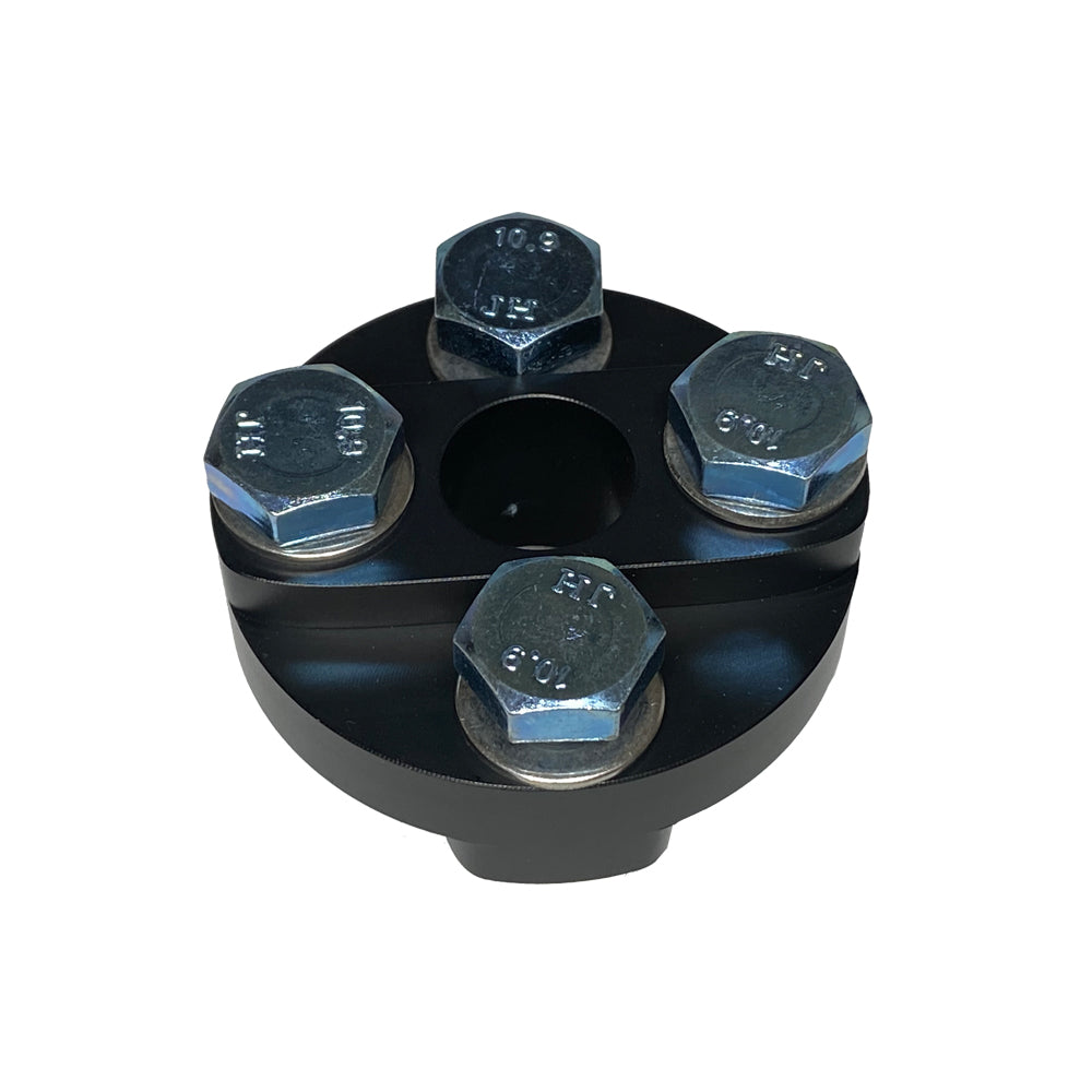

                      Solid joint?
                      Made From 7075-T6 AluminumHard Anodized Black Includes mounting hardware. Looking to replace your worn out steering shaft coupler on your track or race car? A solid 7075-T6 Aluminum coupler eliminates the worn factory rubber bushing giving precise and solid steering feedback. Enjoy the ultimate steering experience in y

                        I've got one of these on the way now myself, along with some new FCABs and bolts for the reinforcement plate.
                        Does anyone know if the Fullers shaft would take the OEM bolts? If they do, I figured it might make sense to pick up a couple new ones to use instead of the supplied ones.

                          Yeah it's the same as OEM.
