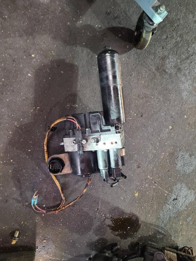

        Interesting. Any pics?
          An SMG unit is just some solenoids, electric motor, couple sensors, a reservoir, accumulator and a bunch of o-rings/seals. I guess it's possible BMW "beefed" up something (larger accumulator?, you can already buy those from MLR) but I don't really see what could be significantly "better" particularly if it costs more. I took a look at some pics of an e60 m5 SMG unit, looks like the same stuff I listed but laid out differently.

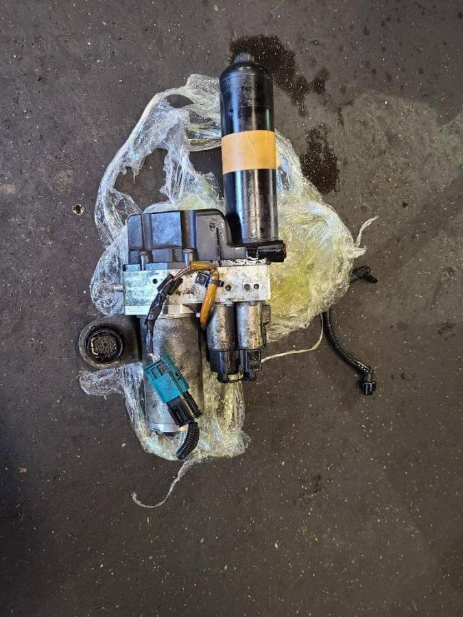

              Here’s a picture of the unit out of the car. Pretty Frankenstein but it worked.

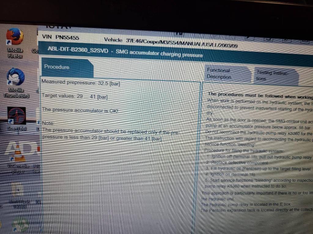

                Didn’t notice any difference, shifted normally. Nothing better or worse. Here’s a picture showing it pressurized ok. Don’t think there was any coding involved either. My mechanic would’ve mentioned if there was.
