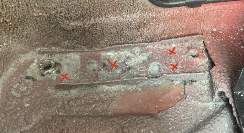

              This is more difficult than I thought. My bracket is covered in undercoating. Anyone know where the spot welds are that I need to drill? Picture of new bracket included.

                You should get a wire wheel for on a drill, it makes quick work of undercoating removal, after that you should see dimples of where the spot welds are, I drew them in your picture where they should be.
                  Thanks for the response! Definitely a prior repair of some sort, I’ll pick up a wire wheel and give it another go soon.
