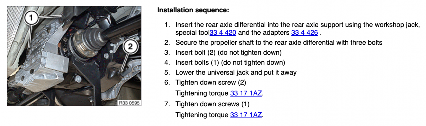

                If anything I would replace the front differential bushing and rear diff cover/bushings “while in there”. And for these bushings I feel the factory ones are plenty good. Depending on your use it’s not always an upgrade to go firmer or poly here. Even if they do sound like it’s sportier-sexier.
                Also, if you’re doing the diff install yourself. I can’t say how often the mistake is made with cross stripping that front diff bolt. So clean it and pay extra attention during install.
                  100% this. Clean both the bolt and the threads in the diff and follow the install sequence from TIS:

                    Thanks, guys. I’m putting on a new diff cover and installing a new front bushing, though the shop is doing the work + install. Stock rubber in both places. I was planning to flag the fragility of the front bushing, but will pass on the TIS for good measure. Appreciate that.
