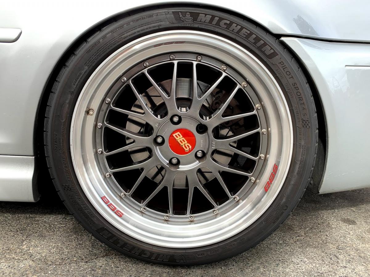

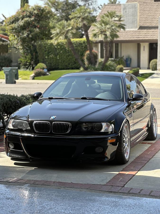

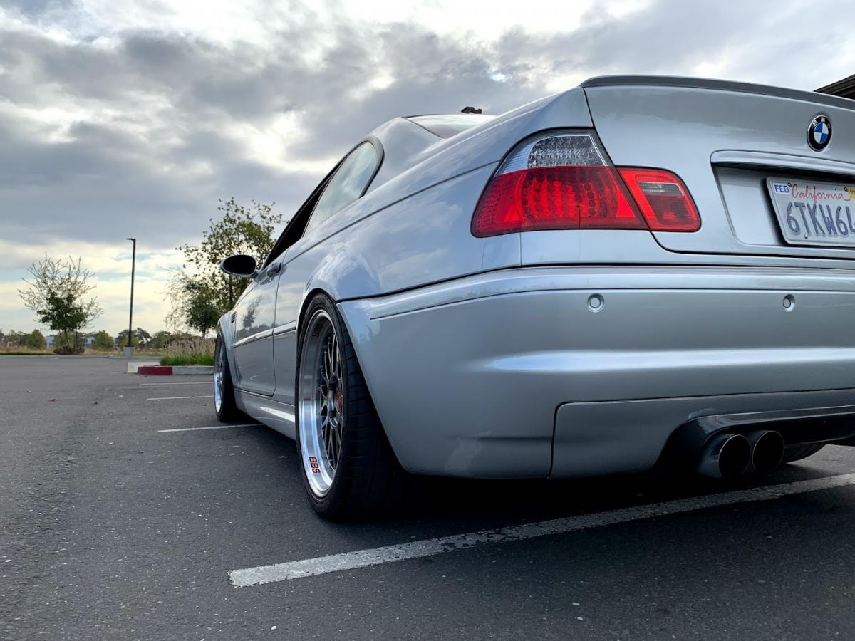

    I was able to fit 295/30/19s on my 10 et 25 BBS LMs on Michelin PSS4s. It works with a slight roll and about a 2.5 degree camber if I recall. You will definitely need a very good alignment shop to help you. I wouldnt cut the fender, thats just me. Since those tires wore out, I decided to go with 285s. I didnt like the fact of the tire so close to the inner sidewall and the fender.

      The tire is showing a lot of rubbing in those pictures. The rubbing will expose bare metal on that rolled lip and start corroding depending on the environment. Better to cut, fold and seal it like on the CSL.

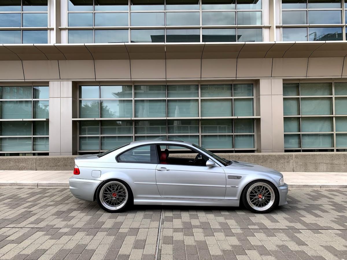

                              Not my car but he runs 18 x 10.5 et22, also states no rub.
