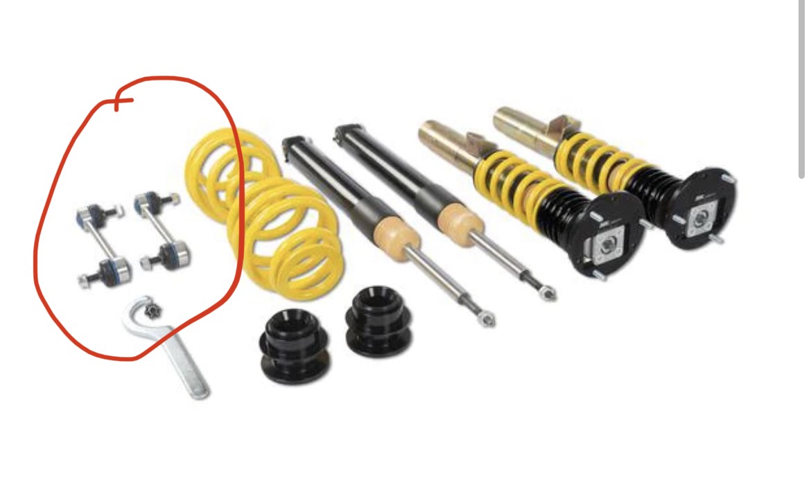

    I am searching to buy a replacement set of front endlinks that come with ST XTA coilovers.
    i checked with ST directly and they have a 3-4 week wait time + shipping delay.
    was wondering if there are any alternatives that I could buy which would fit?
    tia!

    Turner has adjustable endlinks in various lengths. Measure current endlinks and check sizes - https://www.turnermotorsport.com/p-3...s-pair/?pdk=Ag
    KW endlinks are not as good as the rubber boot falls off very easily, but you can order a set from KW/ST directly.
      BimmerWorld has adjustable length end links that will work with KW and presumably, ST dampers. Just email and ask which size you need or call.
      '01 M3, Imola/black
        I bought some super industrial looking ones from MOOG that look like they belong on a tractor, but they were like $15 each and work fine. You'd need to know what length to buy.
          Part number is Meyle 15-16 060 0007/HD​ they are 180mm.
          Part is readily available here in Europe, if you want I could ship you a set if you need it fast, or just get some adjustable ones like the others said.

            these look similar based on what i can see on google, but every description says “rear” - and I need fronts. Is that correct?
              This is likely the same thing as the popular KW "MOOG" match people figured out years ago. There's a thread on these forums about it as well.
                Originally posted by MTL_ZCP View Post
                thanks!
                They are just parts bin from another vehicle, they are actually for the rear of an Alfa Romeo.
                  I bought these on Amazon years ago I needed them fast, they are labeled as KW but they are just Meyle HD links with a crazy price tag. Seems like the same as the 180mm Alfa links, I never measured mine. That current price is insane lol, I would probably just get the Alfa links or adjustable if I was to buy them today. This part number 68510000 in google shows them being sold for less at other places and verifies the 180mm.
                  https://www.amazon.com/dp/B019QIVLVS...roduct_details

                    Ground Control sells different end links depending on what coilover brand you have (Some don't maintain OEM mounting height) - might be worth calling them
