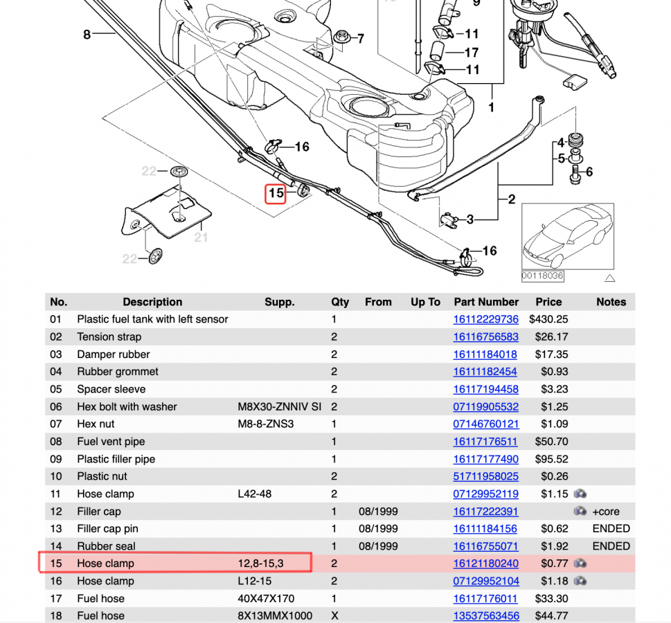

    Hey guys, looking for the correct hose clamp for the fuel lines on top of the fuel tank.
Name:	Screen Shot 2024-02-14 at 5.14.42 PM.png

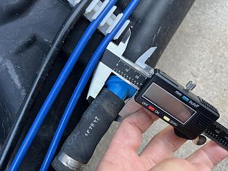

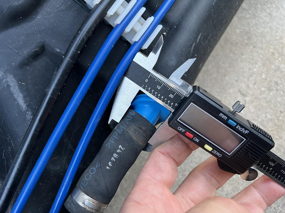

    I ordered 16121180240 which is what RealOEM says, and FCP sent me the correct parts. But these are too small. The hose is about 25-26mm and the clamp is only good up to 15.3mm

    Two questions. Does anyone have the correct part number for a larger hose clamp?
    And perhaps more importantly, is there any reason why I shouldn't just get some similar clamps from McMaster Carr?
    Bonus question: Does it really matter if they are the pinch style clamps vs worm drive?

    Right there it indicates the hose clamp's range is up to 16mm so clearly not the one.
    I found this https://www.realoem.com/bmw/enUS/par...&q=11631716970.

          The clamp still on the hose will have its size stamped on it, I bet this is the one you need: 11631716970​

              You can't always trust RealOEM. I've had a few issues with it lately and have opted to just use ETK which is the actual BMW parts program.
                Since you have access to the ETK, is it actually different that the RealOEM diagram?
                Every time I've seen an issue with the RealOEM it was also an issue with the ETK.
                    ETK is also wrong. I'm not sure how they decided this is the right part number.
                    11 63 1716970 would be the right size clamp.
