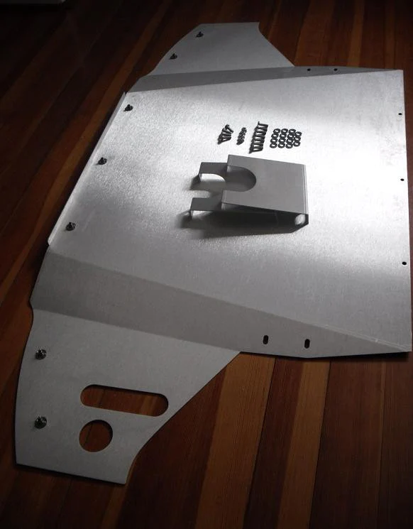

    Anyone own one of the Motion Motorsport undertrays?
    Debating picking a used one up and have a few questions if anyone can chime in with your experience. On the fence if it is even worth it.
    1) Kinda seems like it may be a pain to remove and do maintenance on car once it is installed? Is that true or is it still about as easy as the plastic oem panels?
    2) How does the ambient sensor and circle cut out work? How did you retain this? Do you have to fabricate something? Or am i missing something? Seems like a pain to retain.
    3) I have a hotchkis sway bar that included a reinforcement plate that goes on the studs that the tray also uses for a mounting point. Curious if the stud is even long enough to fit both? Anyone have both? I recall it being very close with the current reinforcement plate.

    I can only answer question 2 confidently. This panel does not replace the front lower wheel well liners, so nothing needs to be done for the ambient temp sensor. The panel will simply butt up against the lower portion of the wheel well liner.

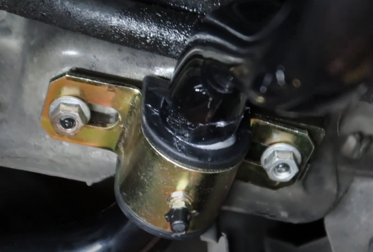

            I have this panel on my M3. It did not induce any noticeable noise from being aluminum vs plastic. I didn't use the hardware for up front, only the sway bar brackets and the rear screws. It fits under the front bumper area, I added a few screws to keep it in place. It takes a few extra minutes to remove it but not a big deal.

              Your pic also helped me see that the sway bar bracket is faced outwards so you have easy access to the lower screws to undo them. Way more room than i thought too.

                  I had this awhile back, it's the way to go if you want something that lasts. The downsides...
                  1. The OE part probably has a very small aero advantage.
                  2. I think the OE part supports the bottom of the front ducting to the oil cooler which is flexible.
                  The contours of the OE part is a bigger deal on the E9X M3 since there is an oil cooler vent with a gurney flap. Not much of an issue with the E46.
                  My biggest complaint was the hardware which does make it a total PIA to remove. Bolts, nuts, washers...do yourself a favor and use stainless rivet nuts to make removal and installation MUCH easier.

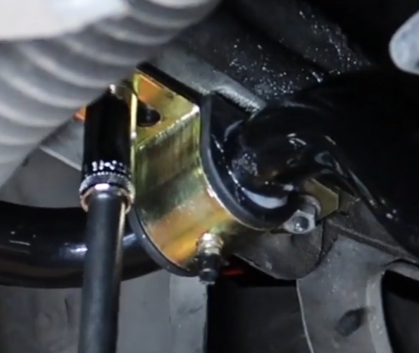

                    Found a video that show the studs - post install with the hotchkis plates.
                    My memory was pretty spot on. Pretty sure there is not enough room for the motion bracket and the nut to fully thread. Stud has a stepped threading at the top.
                    Guess i may need to rethink getting the tray. 😠
                    Figured id post for anyone else that may go down this path later on.
