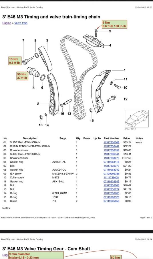

          only upper timing chain guides. 3 and 4 in the diagram

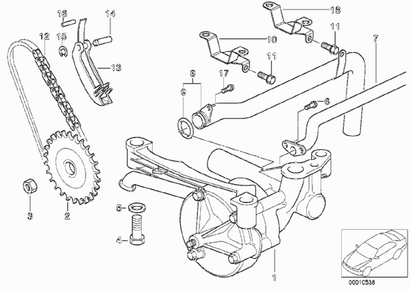

            Number 13 could be broken and oil chain hits oil pump Click image for larger version  Name:	image.png Views:	0 Size:	57.9 KB ID:	255058​

              Then the noise should be continuous.
