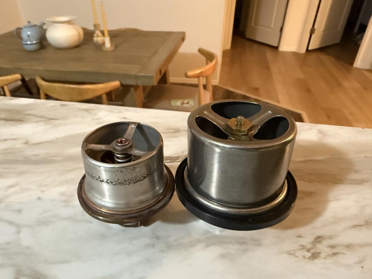

                    Did you try these? I don't think they fit. They are bigger in diameter and do not fit the housing.
                      I have one but i never got round to installing it

                          Did you get the Motorad? I ordered the Motorad 880060 as Gates 33576 and its huge. Comparison in picture. Left is S54, right is Gates 33576.
                            Yes, ok so that's that then LOL. I guess it'll go on the shelf.
