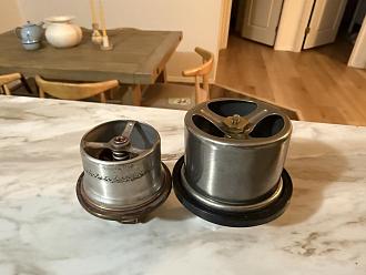

      Originally posted by m3_sancho View Post
      Did you get the Motorad? I ordered the Motorad 880060 as Gates 33576 and its huge. Comparison in picture. Left is S54, right is Gates 33576.
      Click image for larger version  Name:	IMG_7445.jpg Views:	15 Size:	87.1 KB ID:	304563
      Sancho,
      The T-Stat on the right is from E39M5/E34M5.
      The Motorad is garbage brand which is not operating as advertised.
      I have tested them many times and they never ever open at the advertised
      Celsius.
      Let alone that tons of people from other car manufacturer ended up with
      stuck closed thermostat which you don't with our BMWs...You don't want
      to play cheap in this area believe me...
      I will say it again, I DO NOT USE Motorad garbage as some people may possibly
      think I do.
